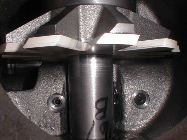

    Bingo we have a winner, if this is an early style machine without the oil separator you could be in for some real fun, the only saving grace may be the fact that it is supposedly grounded, of course what are the chances the gate rotors are still intact?
    They should look like this
    but probably look like this

    Yes you'll want to pull the compressor plates & have a look at the gate rotors, they have teflon/plastic outer layer(as shown above) the bottom picture is an Oh S***! because if that happens all the wonderful shavings will blow into your condenser & lodge (usually in the subcooler) fun for clean -up.
