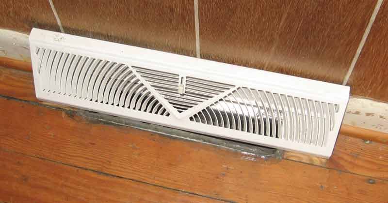

    Another thing I am not too happy with is the vents in the rooms. Included in the installation was new vents in all the rooms. The new vents are about 4 inches wider than the old ones were and thinner. Here is a picture of how they left them:

    Some furnace supply and return pleunms have combined friction or TEL of over 200 feet just by themselves! thats before wet coil,and filter ect. Then theres the trunkline, longest branch and then the registers and grille friction. many systems with box and can trunk and plenums have a TEL of over 300-400 feet! Just by putting in 6x10 instead of 4x10 boots can save substantialy on friction. The grilles in that picture don't look to fit the boot to well.
    By the looks of that grille and energy cost, you must live in Ohio.
