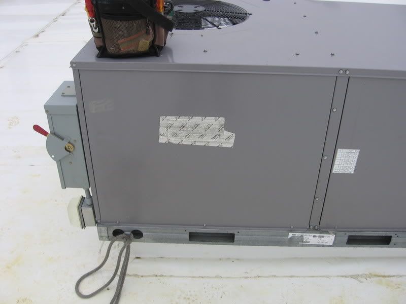

    Get an emergency call for no heat in the building. I get there, check the thermostats, all are calling for two stages of heating. I go up on the rooftop and start checking. First off this retailer has only been open since November 8, 2007 so, everything is relatively new. I didn't expect what I found.
    All four of these units are CARRIER 50TM006A501.
    The LV wires to bring on the heat strips were attached to the wrong terminals in the strip kits, the transformers were set on the 230 volt terminal with the unit receiving 208, the thermostats were wired with one wire on the "O" terminal but these units are electric/electric, not heat pumps.
    Got all that fixed and found more. All four units are setup like these photos, I can't wait to get the corporate owner involved.
    Only three of the four have this little problem. Well, it's not a problem just yet but, how long do yo think that duct tape patch is gonna last? That was the knockout for the internally mounted service disconnect but, Cousin Doofus didn't know what to do so, he just took it out of three of the units.
    I found one of the units operating in heat and cool at the same time but, the thermostat was only calling for 2 stages of heat. Did some deep checking of wires, conduit, diagrams, unit wiring, unit components and lastly, the thermostat. I found where an incorrectly lan'ed wire had arced and that did the thermostat in. This orange wire was tied to the "O" terminal of the LightStat but, it was just hanging there rubbing up against the cabinet in the RTU.
    All of the thermostats are LightStats, I called tech support and found that this sort of failure is most definitely not covered under the LightStat warranty, I guess someone is going to buy a new LightStat.
    I've said it before, I like job security but this is ridiculous!

    Went out first thing this morning to replace the LightStat at this store. I swap 'em out and turn the unit back on and set it to heat. I get both stages of heat but, I have that little nag riding my shoulder so, I check the output from the LV terminals in the Stat, I have 24v to common at every one of them. I turn it off and kill the HV, go up on the roof and take wires loose at the unit LV terminals. I check for shorts in the wires, re-trace the thermostat wire and I don't find anything. Get back to the stat, take off all wires but R and C and turn it back on, I still have 24v at all terminals to C. I moved the setpoint to stop heat with fan on "auto" and W1 & G dropped out but Y1, Y2 and W2 all had 24v to common with no calls for any operation.
    I called LightStat tech support and they are sending me another stat overnite with some return labels to send them both LightStats back so they can look at them. I'm curious to know what the heck is going on here too!

    I think the first one was malfunctioning from the "O" wire arcing to ground(check pics again), the replacement had all relays on at once. Like I said, there's no problem with the wires from the stat to the unit, it's the stat. I even took off the board covers inside the stats looking for a switch, a jumper or something for a solution.
    If I could use some other stat I most assuredly would, this retailer requires LightStats in all of their establishments, no others are allowed under any circumstances.
