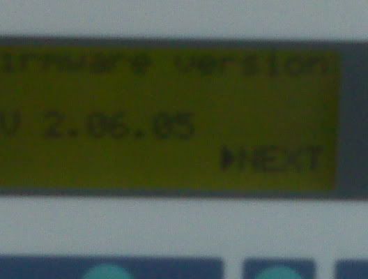

    step #1
    firmware version
    V 2.06.05
    ______________________ >next

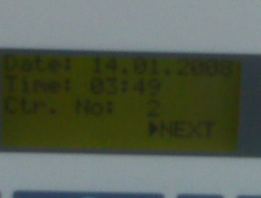

    step #2
    Date: 24.02.08
    Time: 03:49
    Ctr. No: 2
    _______________________>next

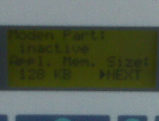

    step #3
    Modem Part:
    inactive
    Appl. Mem. Size:
    128 KB >NEXT

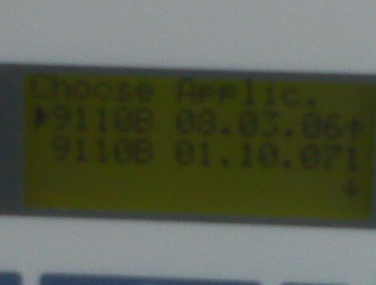

    step #5
    Choose Applic.
    9110b 08.03.06
    step #6
    I Select Applic, "9110b 08.03.06" and hit next

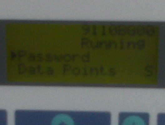

    9110bg00
    Running
    >Password
    DataPoints S

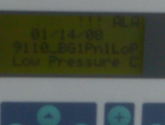

    error pops up and it says
    step #8
    !!! ALA 01/14/08
    9110_BG1Pn1Lop
    Low Pressure C
    i hit cancel, and proceed

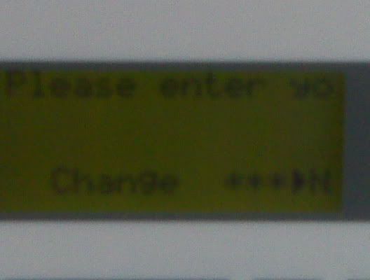

    step #9
    Please eneter password
    __________3333
    NEXT
    step #10
    Please enter your password
    Change _____________****>N
    hit next

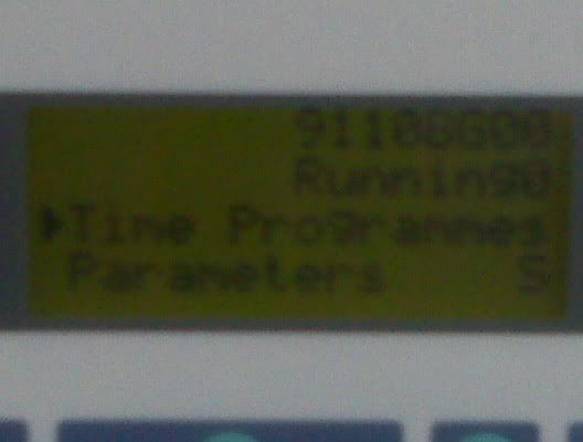

    9110b00
    Running
    >Time Programmes
    Parameters S
    hit next
    step #12

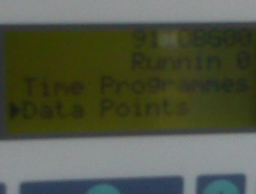

    Time Programme
    9110bg00
    Running 0
    Time Programmes
    >data Points
    hit next

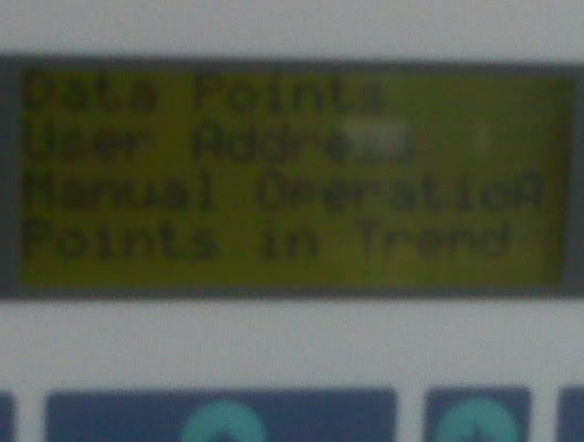

    step #13
    Data Points
    User Address
    Manual Operation A
    Points in Trend
    next

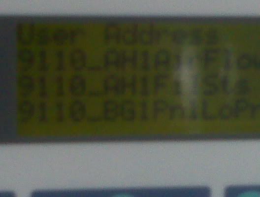

    step #14
    User Address
    9110_ah1airflo
    9110_aha1faists
    9110_Bg1pn1lopr

    Usually xl-50's are programmed with Honeywell's C.A.R.E. It includes xl online. You can get xl online as a stand alone tho. You have to buy from Honeywell. It looks like you have a low pressure alarm in building 1.
    "!!! ALA 01/14/08
    9110_BG1Pn1Lop
    Low Pressure C"
    The C could mean cutout, or a clue to the low pressure control.
    If there is a lockout routine in the programming then the equiptment won't start until you correct the low pressure situation. You can use the MMI on the front of the control to scroll to the point "9110_Bg1pn1lopr" and see the pressure value being reported to the xl-50. You shouldn't have to do a reset after you correct the low press. You may have to toggle the occ/unocc point.

    When you refer to "reset" in your original post do you mean you are pressing the "reset" button behind the i/o terminal strip on the controller?
    If so you are dumping the software in the controller everytime and then in the process you described you are reloading the application stored in the flash EPROM on the controller. This is not neccessary on an operating controller and is wiping out any overrides and setpoint changes in the controller points.

    It looks to me like the program that was in the NV RAM has the wrong file set. The XL50 has a smaller display than the XI581/582 so when you set up the controller, you have to select the right file set for the display you'll be using. If you select the external display (XI581/2) file set, it will load (because you can use the external display with XL50s), but the built-in display will be truncated, as it seems yours are. The only solution is to change the file set which will require CARE.

    Agree with rad1. The application is running, but the alarm that came up on startup seems to be preventing the unit from running. Possibly a manual reset pressure switch?

    here is a bit more info that i should of put in..
    b4 i rest the ddc "- + down" "< does the same as the switch in the back"
    after i reloaded the app its not the same display at all as it was b4...
    its like i have all my settings still but the menu interface is gone, i have rest one other one and it was fine after i reloaded the appl to it...
    here is a look at how it is now.. it wasnt like this b4
    its like the app is still there but the part of the app that tie it all togeather is gone...

    71
    In img00171 there are two applications stored. It looks like the application you restored may be an older one.
    You could try restoring the application with 01.10.07 at the end. Maybe that is the application that has the corrected display settings for the XL50 that were showing up before the reset..
