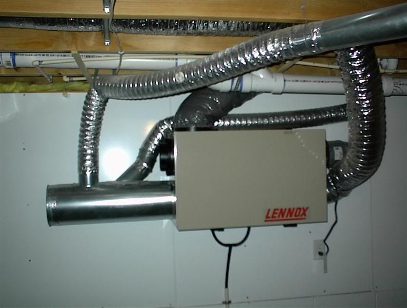

    here's a bunch of pics off of one of our work cameras. Most fit the wall of shame, some are just misc. stuff, but my favorite is the brand new air exchanger. Also the tight fitting downflow.

    I know that fine art work!!! I've seen it numbers of homes like that!
    My aunt had a modular home put in about 10 years ago, she asked who she should go with, I said you guys... Well, I go out to her home a week later, and saw a work like this.... I said umm.. What happened to D&S? She said they were too hight, B's was a better price..
    B had the furnace exhaust 6" away from the intake vent of the ERV, I told her I hate to be a prick, you got what you paid for!
    Guess she got them back to move the exhaust to the side of the house where the A/C was, and moved the A/C to where the exhaust was..
    I don't know how many homes I've driven by with the exhaust so close to the ERV intake.... And also what t's me off they now use the BAYVENT, I at first thought, I know your company knows better... then I saw the Lennox unit..
