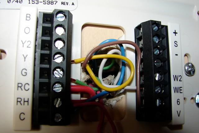

    I Just had a new 75,000 BTU Rheem Classic 90 Plus Modulating gas furnace with the mod TST401MDMS thermo and humidifier, along with a Classic series 2 1/2 ton AC unit installed in a 1500 sq ft home by a Rheem dealer.
    The fan was running at full speed when the heat was on, as well as when it wasn't. After a little research here, I discovered the wiring may not have been correct. The "w" was wired to W2, I changed it to W/E.
    I also noticed the "G" from thermo was going to the Y/Y2 on the furnace, I switched this wire to the "G" on the furnace.
    I hope everything else is hooked up properly, so I thought I would post a couple pics.
    Another question, should the fan be set to operate in "auto" mode or "on"?
    Also, I notice air blowing out (in a couple small areas) between the furnace and the "box" that sits on top of the furnace, enough to possibly blow out a candle. Is this normal?

    Cooling at the furnace should be on Y/Y2 or you won't get enough airflow and yes, W/E at the stat for heat. Too bad you have to correct the installer errors.
    While heating, look through the window and make sure you get a capitol H on the LED. That means the sucker is modulating.
    The air leaks should be caulked. Have the dealer do that when they come back and correct the Y wire.

    So, to be sure I understand, the green wire at the "G" in the thermo should go to the Y/Y2 on the furnace, and not the "G" on the furnace where it is now?
    38,854
    You're OK with G on G. Have the dealer (since I can't give DIY advice) correct the yellow wire.

    That yellow wire is sticking too far out and almost or is hitting a resistor. Your installer should be careful to not stick the wires out too far.
    Apr 2004
    7,680
    Bald, he's already in it and seems competent enough.
    Move the Yellow wire on the furnace to Y/Y2.

    Quote Originally Posted by htrguy View Post
    Good eyes...
    Yeah, that wire should of been shorter. Just hopefuly it's cut shorter when it's moved down to the next screw.
