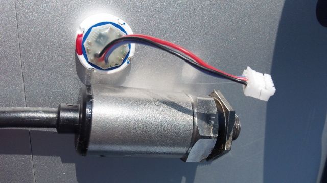

    These are shielded transducers in a DigiCool 1200 and are in all of the DigiCool digitals and the Yellow Jacket digital. They are stainless steel and do not get bothered by any electrical noise. The Testo digital uses a ceramic transducer that is sealed with a oring. I don't know if the leak problem that they have had is because of this or something else.
    Here is a pic of those testo transducers next to the Digi-Cool
    Guys had two of the J/B's at work both died and it didn't seem like the saturation temps lined up to the pressure when they did work.

    You know , those photos would make for a really good topic instead of being buried in a 5 year old post , just saying.
    But in response to the photos , ...it's no wonder the other brands end up
    " DEADED " , DEADED , and deaded , BUSTEDED !!!! I mean really , look at the difference ( CLOVER , LOOK AT THE DIFFERENCE !!! ). This is sure to twist into some off the wall argument , but these photo's end the discussion for anything reasonable .

    Anyone got a pic of a fieldpiece transducer?
    13,992
    It looks a lot like the testo style from the top except it looks like a nut that holds it all together where the testo had a screwed down plate.
    Not sure what you can tell from pics but that J/B seemed like a joke for the price they were selling them at the time. Not funny if it is junk now I guess.
