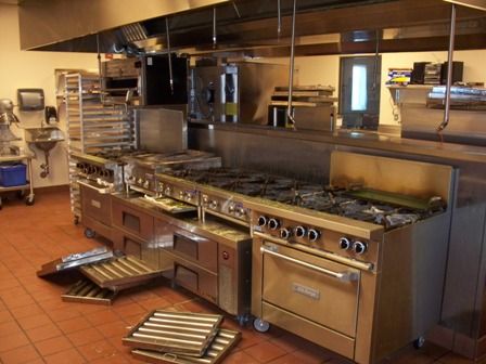

    Is that paint?
    Dry as a bone Tucson
    4,883
    Quote Originally Posted by stebs View Post
    Is that paint?
    No......it's the fire suppressant that comes out when the link is broken.
    This happens to be out of an "Ansul" system that their installers put 165 degree links in. Messy aint it?
    The clean up bill was over $10,000.00. So much for their profit on this job.
