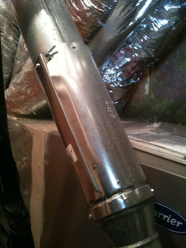

    It was "inspected" in Colleyville Texas, and got a green tag!
    Not shown in the picture is the 17 1/7" Carrier N coil mated directly to a 14 1/2" furnace, with the offset the wrong way per the instructions laying on top of the coil, causing 1/3 of the coil to get 0 airflow.

    Wow. Did they cut a section of b vent to make it fit?

    No, it is a 1" adjustable fitting installed backwards.
    It wouldn't fit the right way because it is a Selkirk brand fitting, which doesn't fit the existing Metalfab brand B-vent.

    That setup is a transmitter of CO just looking for a victim.
