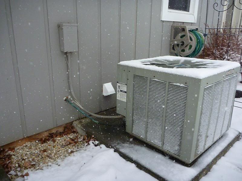

Size:  50.6 KBThanks for the reply. Our current heat pump is a 3.5 ton. Of the 4 quotes I've had, no one mentioned a Manual J which is disappointing. The company that I have the best "gut" feeling about told me I'd be fine with a 4 ton but I could bring my home's blueprints by their office and they could calculate it for me. From my research, I think blueprints alone would not suffice. I honestly think that would still tell me to get a 4 ton unit which would probably be fine anyway.
    I asked the lady if the unit I was looking at would be tax credit eligible and this is what she wrote.
    TO QUALIFY ON THE 20 SEER ON THE PAPERWORK IT SHOWS TO USE THE TAM7 INSTEAD OF THE TAM8 (COMMUNICATING) AND ON THE 16 & 15 SEER BOTH QUALIFY WITH THE TAM7 BLOWER CABINET. I CAN MAKE THE 20 SEER WORK BUT IF YOU PURCHASE THE 20 SEER YOU WOULD WANT TO KEEP IT COMMUNICATING. NOT SURE WHY THEY HAVE IT THAT WAY......THEY MAY NOT HAVE UPDATED THEIR TAX FORM PAPERS
    Anyone know if a XL20i paired with a TAM8 air handler would be tax credit eligible?

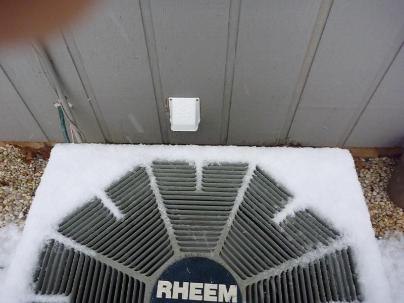

    Also, I have a problem. My clothes dryer exhaust vent is almost dead center of my outside unit. If I relocate the dryer vent anywhere within the laundry room closet, it still would blow out onto the unit. Do I have any other options besides relocating the new unit away from the dryer vent? Any way to divert the dryer exhaust away but still be aesthetically appealing? Also, my line-set enters the house inside the washer/dryer area and then 90's up along the wall, goes across the ceiling, and comes down to the air handler. I'm thinking with the new unit, I'll have them just enter the house at the same spot but run the new line-set behind the washer and dryer and into the air handler. Thoughts?
    Yes the XL20i will be eliable for $300
    Tax credit when paired with variable speed. This system can be used with either the tam7 (non comm.) or tam8 (comm. air handler). I would Chosse the tam8 with the XL20 so it will be commicating system. As others have posted systems from Trane's XR15-XL20 can quality for federal tax credits and special financing options or instant rebates when paired with a variable speed air handler. You still need to get a load cal done to ensure proper sizing!!!!
    As for the dry vent coming out right behind the unit. Is there room to the left of the existing unit and pad to move it over. If so I would suggest relocating it as far away from the dryer vent as per you can be relocating. Do they plan to reuse the existing line set or pull a new one. If a new line will be pulled they should be able to bring it through the attic and out the side of the house or at the eave. They could install a line set cover for looks. Where is your air handler located in a closet or attic?
    If your budget will allow I would choose the XL20 over the XL16 due to having 2 compressors and better performance for comfort and effeicenty reasons. What size line set do you have now? Looks like 3/4 and 3/8 from the pic but I could be wrong? Depending on the distance from the air handler and some other variables most (4) ton systems need 7/8 and 3/8 line set sizes to work properly.

    They stated they would replace the line-set. The smaller tube is 1/4" which they stated was way too small. The bigger line looks to be 3/4". It's probably no more than 12' from the outside unit to the air handler which is on first floor (I'm on a slab). In the pic where you see the line-set entering the house, that is the end of the laundry closet. I really don't have any options of moving the vent because it will still blow onto the heatpump. Guess I'll just have them move the heat pump over to the right closer to our patio.
