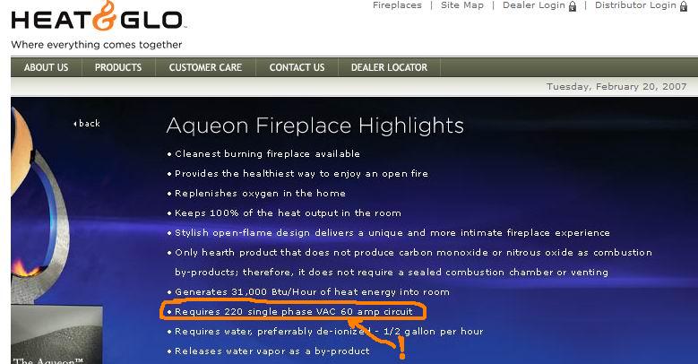

    Ok, the thing you have to understand is that the water is not the fuel, the HHO gas is the fuel. To crack the water into HHO gas, a large amount of electricity is required.
    Check out what I have circled on this add from Heat&Glo's site.
    Note that you need a 60A 220v electrical circuit to run this 31k btuh fireplace. Thats the same sized electrical circuit that would normally be used for a 10 kw electric heat package, and the 10 kw heat package would give you more heat.
    I personally think that fireplace is a neat product, but please don't mistake it for an efficient source of heat.
