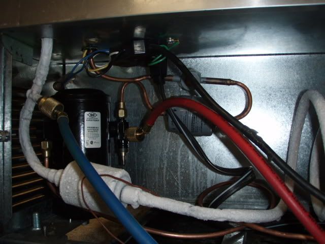

    synopsis R-404a system running high liquid line pressure 310 to 320 psi, no load onfreezer, 0*F case temp. 80*F ambient air in room, 28psi suction 10*F superheat full colum of liquid in sight glass slowly charged till glass cleared, it's 11:30 i may have forfgot other info I'm tired now!! haha
    Let me start off with this, the model is a TUC-48f little 2 door undecounter thingy. This Freeser has had a "troubled history" lots of service calls over the past 6 years of operation. I looked back through the records of all the service done on the machine, this customer actually had good records!
    Most of the service on the machine had to do with blocked condenser and/or blocked air flow to condenser. I think we can all agree that that situation is hell for these little systems with the newer refrigerants and POE.
    Over a year ago or maybe better on two the system had a blocked cap tube so it was opened and cleared by blowing nitrogen through it. It worked dandy for 7 months, then same problems re-occured. I assume it was the same tech but this time the cap tube had been replaced(and it was obvious) system worked again for almost a year again.
    My Turn:
    System running in a vacuum on low side so i preformed a prwessure test on nitrogen and system held 250psi for over 2 days with out budging, no leak right? (Itwas during that time i looked in to the history on freezer)
    After having a grand old chat with one of the techs at true basically comming to the conclusion that with the history we probably had a contaminated system from the POE oil breaking down under the high heat situations and thus blocking the little bastard um i mean cap tube!
    I was in the mood to experiment with this little freezer so i decided that I would get rid of that little cap tube and install a TXV and reciever, so I did. the idea sounded fun but once i got nto it i was reminded how i hate working on little reachi-ins who really like sharp sheet metal cuts anyway haha!
    So now I have the freezer running and there is excessive head pressure 310-320psi on the liquid line, suction is 28ish psi and superheat is around 8*F
    case temp is is steady at -5*F to 0*F
    system is still running on the temperature control but i was thinking of throwing on a pressure control in there to cycle it.
    any ideas on what to look for?
    thank
    -Mike

    As I see it, by converting this system to a TEV with receiver you now getting much better performance from a generously sized evaporator as indicated by the much higher suction pressure and lower superheat than the original factory design with a cap tube feed would allow. The higher suction increases the compressor capacity immensely by about twice is factory spec and with that, the total heat of rejection that the relatively small condenser must handle is also nearly doubled.
    If you look at the discharge pressures that you are seeing as compared to what True said they should normally be and their corresponding saturated condensing temps, you can see that the factory condenser TD at say a 75ºF ambient is approximately 25ºF whereas your new TD looks more like about 50ºF....or double what it used to be. That's just what I would expect to see if the compressor capacity is doubled.
    I think the answer here is to increase you superheat to more closely match that of what you would get with the cap tube setup, which I dare say will be much higher than what you have now. I would guess that a True freezer like this would actually run compressor superheats in the 50ºF+ range. (Yes that's higher than what the compressor makers would like to see, but it's more in line with what True sets them up for.) This will lower the suction pressure, decrease the compressor capacity and as such the condenser TD and subsequent discharge pressure will drop back to a more comfortable level.
    I think this little rig will run pretty sweet once you getthe bugs out.

    ckecked on this freezer agaon today, the last time i checked it out i reduced the charge by dumping a little liquid into a jug to reduce head pressure i also upped the superheat settging on the TEV
    checked it out and I had 250 head and 12psi back. the sight glass was low and cabinet temp was around 32F, by the look of the coil it looked to have a low charge, TEV was frosted and so was first part of coil
    I added a little 404a and brought the liquid level in the glass up sone but still not full, I have a few different readings and case temop was dropping
    rome readings after adding more juice
    Suction 22psi 43F
    Reciever outlet 300psi 104F
    Condenser outlet 106F
    Discharge 138F
    Condenser inlet air 79F
    Condenmser outlet air 102F
    I'm starting to think that this just may not work out for me and i may just throw back in a $10 capilary tube but I really don't want to haha
    maybe i need an orface after the TEV or something, im usinf a sporlan 1/4 404a TEV, or like was mentioned a bigger condenser coil?
    any ideas or is wheel reinvention time over? hahaha
    -Mike

    I have been watching this thread for a while and I do not understand it at all.
    Why did you ever feel that 310 to 320 head was too high?
    I mean WTF that is NOT high for 404 at all. 350 would make me raise an eyebrow but anything under 300 would be more of a redflag.
    Saturation temps of 100 to 130 are not totally out of line for kitchen equipment though something at the 130 level is workin real hard! The TEV you installed is set out of the box with a pressure drop design that is at 100 SCT
    It is an old rule of thumb and not really a good one but the 30 over ambient is not outragous on little boxes like that.

    I wouldn't advise getting deeper into this mess by trying R134A. It will run, but you'll lose 30-40% capacity right off the bat and you'll need to change the TEV as well.
    Did you try adjusting the evap SH higher like I suggested earlier? I really think that will make this puppy work.

    Quote Originally Posted by icemeister View Post
    Doh on the bulb charge haha
    yeah i screw it almost all the way
    the first time i adjusted the SH the next time i went back to it the breaker had tripped some time over the weekend.
    i has my supco tem,p recorder in it too haha too bad that recorder didn't have pressure and amperage inputs haha
    just on a side note with the capacity loss with 134 but the gain of having a TEV i'd probably be in the same level as far as capacity with 404 and a captube ya think, i doubt i'll change it but it wouldn't be that difficult, all i got to fo is buy a 134a power element for the sporlan TEV(edit: and maybe the orface too), I'd name that sporlan system but i forget what they call it when ya can mix and match valves with a few parts
