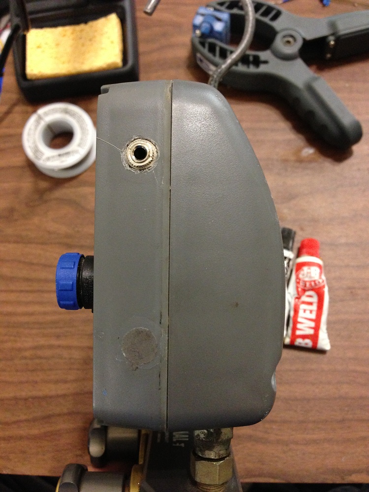

    The maximum difference in resistance between the stock Digi-Cool thermistor and the Cooper probe was 0.2 ohms, from -10ºF through +200ºF.

    I like it because it will fill in tiny voids, even under capacitors and other parts on PCB boards, but is easy to peal back off without tearing parts off the PCB.
    Of course the most important thing is that it doesn't off gas anything that will eat electronics while it's curing, like a lot of silicon products do.

    Except for some minor cleanup, and putting a new protective boot on it, I'm pretty much done with them.
    Fixed the booboo.
    JB Weld worked quite nicely for patching the "mistake hole".
    Action shot.
    What's 1ºF between friends?
    The little UEI was my first digital thermometer, I got it in a pawn shop for $5 about 21 years ago.
    I've never had a J-type thermocouple for it, but it has always been happy with K-type thermocouples.
