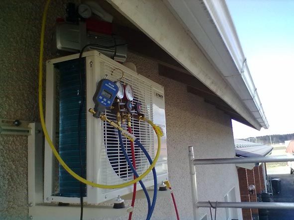

    Hi everyone
    I have had the required training and have the licence needed to fit and work on small systems (up to 3kg of refrigerant). Over here they are becoming popular as heat pumps, although of course if it does get hot in the summer they work in reverse too. The ones I work with are R410A with flared copper pipe fittings.
    Although I sell and fit them, I've been wondering how others around the world pressure test and vacuum systems like these. I've asked around, including those who trained me and the technical staff at companies whose pumps I sell and install, and I have heard wildly varying views about the need for pressure testing, vacuum time etc. One guy who has installed and sold these for years says he doesn't pressure test at all...
    Would any of you be happy to share how you go about pressure testing and pulling a vacuum on these?

    Thanks for your replies. I guessed there are probably lots of threads already, but to be honest I get lost in the terminology as I haven't learned it in English, and US guys might use different terminology to European! I wanted to be sure we're talking about the same thing, not gas or water pressures in heating systems or something else
    I was mainly hoping to hear about people's opinions and experiences on methods. For example, many have told me it's pointless and unnecessary to pressure test using nitrogen. (I do it anyway, I don't see how it can be pointless). Also length of vacuum time, vacuum levels reached, etc. I'll try and find good threads on here

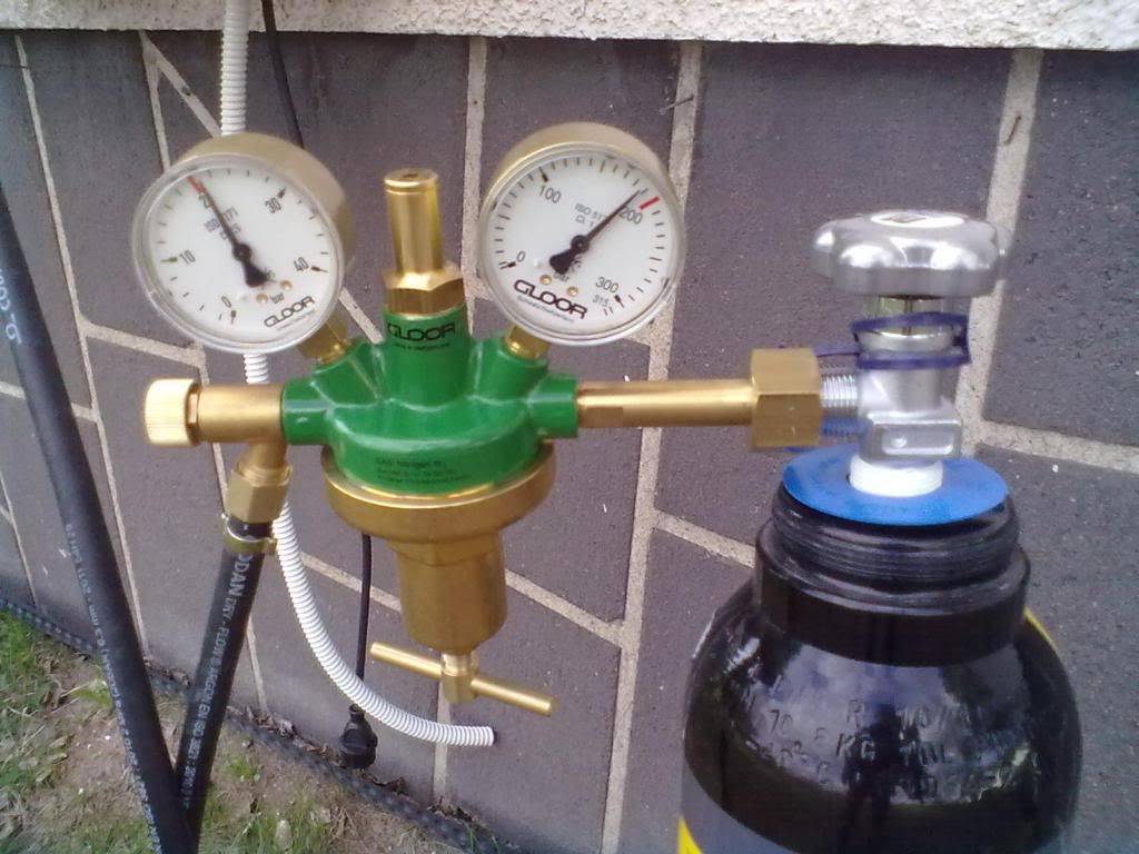

    I use a Refco manifold and hoses, Robinair vacuum pump, ITE 54V vacuum gauge and Gloor nitrogen regulator. I pressure test with the hose from the Gloor straight into the unit, not via the manifolds. Then I hook everything else up and evacuate the system. Here's a few pictures:

    I believe as you are in europe the regulation you that covers your question is EN 378.
    http://www.feta.co.uk/uploaded_image...kTightness.pdf
    There are two tests to be done, a strenght test and a leak test. The strenght test is i believe 1.1 to 1.3 times the maximum working pressure of the system. This strenght test can be around 800psi on a R410A system depending on what the high pressure switch is designed to stop the system at.
    A leak tightness test is i think equal to or above the maximum working pressure, (but not above 1.3 times)
    But in practice if you do this the nitrogen will leak by the service valves and into the outdoor unit causing you a lot of problems. So what i would do is either strenght test and leak test the pipework and indoor units before you connect to the outdoor unit (which is what we do on vrf systems) then connect and leak check the connections.
    On a small split system such as the ones in your picture i would look up the pressure of the refrigerant for the temperature ona pt chart (or phone app) of the day you are working and test to just below that to prevent the nitrogen getting past the service valves if the leak, i have had this happen a few times.
    e.g. Its 20C today so thats a 195psi for R410A, so i would test to 180psi nitrogen and check for leaks etc, if you are leaving the nitrogen in overnight then you would need to take account of cooler temperatures. If it was 15C that would be 167psi R410A so maybe 155psi test pressure.
