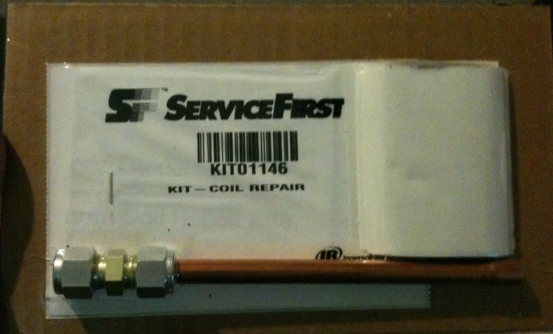

    Thank you for the info on the Seacoast kit. Over the years that is where I have seen leaks develop and it is impossible to repair the aluminum to copper joints. It usually occurs on units of 5 plus years or older.
    AS/Trane distributors sell a repair kit, it works quite well if you follow the instructions.

    I've repaired alum to copper tubing with a flare tool and coupler. Our Trane dealer doesn't or won't supply the repair kit. Some of my Trane units are in their 4th decade and I hate to think they can't be fixed.
