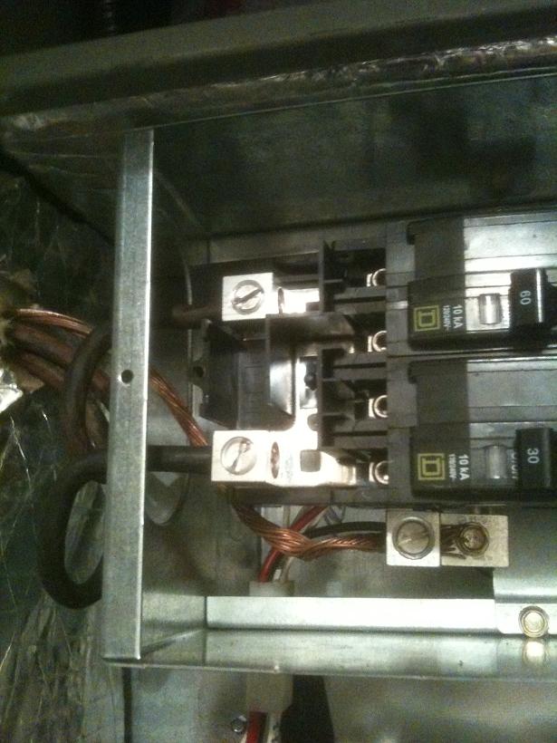

    Quote Originally Posted by pacnw View Post
    2) is the jumper set up okay? usually there is a buss bar or factory metal and plastic splitter to do this.
    No, the field installed jumpers between breakers are not ok. It is how it is often, even usually done, but it is not ok.
    1 lug, 1 conductor.
    The over heating problem you are getting with the bottom breaker likely has its roots in having 2 conductors stuffed in the lugs of the breaker.
    Every equipment manufacturer I've ever checked has some sort of single point power entry kit.
    Usually it includes a jumper bar assembly that connects between the breakers, possibly a sticker to amend the units wiring diagram, sometimes extra sheet metal bits, a larger ground lug, etc..
    Some, like Goodman, have a terminal block that the supply wires connect to one side of, and 4 wires from the block to the breakers.
    Most of the breaker manufacturers have some sort of jumper bar available, with appropriate UL listings, etc., for sets of 2 or 3 breakers to be fed by a single power supply.
    Note that if both breakers don't have the same size lugs, you can't use a jumper bar. Goodman sent out bulletins about the issue regarding their 15kw heat packages a few years ago, which is why their single point kit is a terminal block and wires.
    Incorrect:
    Correct:

    8,028
    Correct:
    Yes, this is what I thought was needed!!!

    Now that is nice and clean.
