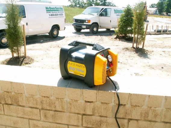

    Like others that have posted I use the Appion G5 Twin. I have also run #1000's of pounds of refrigerant through it and it kicks a$$ everytime. One time it took about 45 seconds to pull 1 pound or R-11 out of an old Carrier 19C machine into a sample bottle. The machine was setting at 10" of vacuum. Another time I let a co-worker use it to pull #150 lbs. of R-134a out of a Carrier 30hxa used to make ice at an ice rink, his RG5410a machine was only making 1 lb every 8-10 minutes... Refrigerant temps were right around 0-5 degrees.
    The direct suction is what makes it the best for our use. The oil doesn't wiped from the crank bearings with the introduction of liquid.

    I forgot to mention that the Appion only weighs 21#'s . The thing literally is lighter than my everyday toolbag .

    Talking i have six of these
    Quote Originally Posted by refrtech View Post
    By far the fastest I have used !!
    I have had it for about 1 year now . I was the first tech in our shop to buy one and now the boss has bought them for everyone . I have probobally pumped 5,000lbs of liquid refrigerant through it , charging and recovering and I have never had a problem with it . I have clocked it @ just over 7 lbs per minute while charging or recovering liquid .
    Before this one I had the CPS liquid pump and it sucked !! Biggest POS recovery unit I have ever used .
    Stick with the Appion , you will not be let down .
    when you pull them on roof its the lighest on the market, and best one out there, i just finished two years on road warrenty work, we pumped out 1000 machines,i can supply pics, averaged 50 lbs per machine, only had two units go dwn on cracked copper lines, easy to fixthem up and keeped pumping. they r two cylinders, pump out alot of freon quick and draws down to low vacuum. great unit, i had used the promax(POS) THE CPS HEAVY AS BRICK AL BOXES THAT WEAR OUT, breaks rods and doesnt pump down
