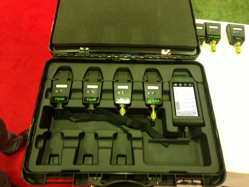

    The booth where I had a "mind = blown" moment.
    I feel like this is what I've been waiting for, for the better part of 2 decades now.
    I'll have more pictures in the next day or so, but here are a couple of teasers.
    The case these items are in also serves as a recharging station for the rechargeable batteries in each one.
    I took a picture of the wrong screen, one of them shows the SH and SC calculations, along with saturated temperatures, and readings for up to 10 sensors.
    And yes, it is exactly what it appears to be, and with a 100 YARD range on the transmitters for the US product, the rest of the world gets a 200 yard range.
    Expect to pay in the $2500 range once there is a place to buy it from in the US.
    http://www.metreco.com/

    Is it really coming to market? They were at past shows. Were they at the Inficon booth again this year or have their own?
    If I remember right the box is a charger too

    Looks neat. I'd be in, but not for that price tag.....
    Mar 2006
    Denver/Boulder
    2,675
    Pricey as it is, it should be remembered that others have offered less functionality for more money.
    I definitely think this is headed in the right direction. I still don't understand why somebody doesn't snap a module on the end of a smartphone or tablet for the communications and use the power of mass production to drop the cost and complexity of producing these devices. That way they can focus on the sensors and the programming of features.

    Saw these at Chillventa in Germany in 2010. Was told they would be in the states soon. Still waiting

    To bad we can't get the 200 yard version, I hate having to hunt for signals on my wireless probes.

    So I'm not up on all of this wireless stuff. What will be the advantage of something like this over something like the SMAN4? And visa versa?

    Agreed, but 100 yards is a little over 4.5 times the range of Testo or Fieldpiece wireless probes.
    Then again, if they don't come out with a wireless WB temperature probe, that is actually useful for in duct measurements through a test hole, all that range won't really matter.
    Quote Originally Posted by MalcolmHinkleRefrig View Post
    No manifold, no hoses, no wires.
    The pressure transmitters would be used with access fittings that allow you to hook up a hose if the charge needed to be adjusted. The kit they have packaged includes the hoses and fittings.
    Outside of the initial installation, and refrigerant side repairs, a refrigerant manifold and hoses are, at best, a necessary evil, mostly evil.
