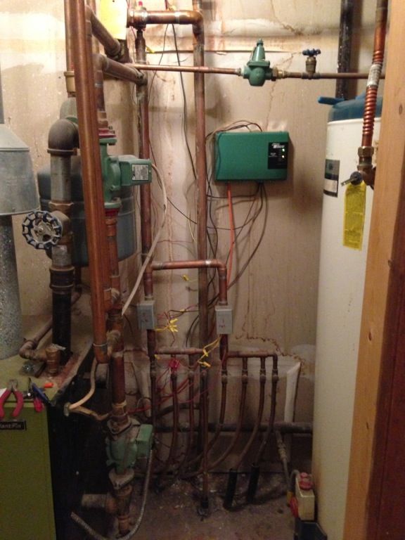

    I just bought a new house and I am trying to sort out the hydronic system. The house was built in 1978, and a lot of the work seems to be owner/brother in law type stuff. However, the heat does work, so that is a good start. There are four zones - two upstairs running baseboards and two downstairs heating the slab. After the first month's bill that showed 226 therms, I want to have a little bit better control over the system (also, of course I am doing things like sealing up the 3/4" gaps in the windows, etc.)

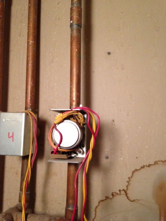

    Issue #1: upstairs bedroom heat never really goes full on (baseboard warm, but not producing a lot), and it also does not shut off if any other zone is on, even if its thermostat is not calling for heat. I think the culprit is the zone valve. I went ahead and bought a taco zone control unit (shown partially installed in the pic) to help sort out and diagnose these issues, and it shows a call for heat but the zone valve not open. Could it be stuck partway open? I bought a new zone valve with the hope of switching out the powerheads, but it started losing water when I unscrewed it, so I guess I will have to replace the whole valve, requiring me to drain the system. Does it sound like I am on the right track?

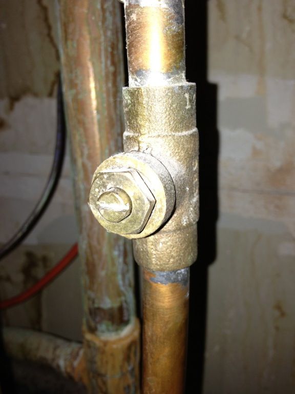

    Issue #2: what is this valve called and how does it work?
    Is it a 90 degree turn from full on to full off, or is it more complicated than that?

    The valve with the slot is to manually balance flow. That rats nest of wiring for the zone system needs attention for sure.

    Being that it's a new home and it has a heating system that you're not sure of what your looking at (in some instances) may I suggest that you call in a professional to look things over and give you an assessment as to how it's performing and what they see as things that either need fixing now and things that can be improved on. If nothing else you should come away from the visit with all safety items being confirmed as functioning properly and a crash course on hydronic heating systems.
    From your first picture I see 2 things at a glance that concern me from a safety standpoint. I see what looks to be a pressure relief valve on your boiler that is plumbed wrong. I also see signs of improper venting/burning of your water heater. Those two things both fall into the category of "can cause serious injury or death" in any instruction or book.
    The zone heating problems could be due to the zone valves, controls malfunctioning or not wired correctly, piping mistakes, circulator issues or a host of other things. If what you have is the copper fin tube radiators they should become room temperature in about an hour at most. If they aren't, you still have flow through those zones when you think you shouldn't.

    Good catch on the water heater firecontol. I wonder where both of them reliefs are piped to? I'm seeing infloor tube and maybe some fintube and I don't see a mixing valve of any sort but maybe it's out of sight. From what I see you really should get a tech out just to check it over.

    I took a little more time to look at the photo and try to figure out what's there. The twin circulators in series look like they would work against each other and create flow path problems because of the intersecting return lines betwen them. At any rate, find a good hydronics tech and have him go over the system with you to trace it out. Us taking pot shots at it won't help you much I'm afraid.

    Relief valves need to discharge by gravity to a safe location.
    Another one of those things you know, but don't necessarily know why you know it or can't easily reference the section and paragraph.
    For that reason I always discharge the relief down (gravity) and terminate not less than 6" from the floor. It's the same knowledge base that mandates that all reliefs physically need to be installed vertically. It has to do with keeping them free of obstructions and debris on both sides. I guess the union could be considered a makeshift way of allowing for testing and then insuring the discharge was empty afterwards. Just another good reason to have a local qualified tech look things over, hopefully one that is up on the local code requirements.
    If there isn't a drain in the room for it to drain to then I strongly suggest that one be installed or make sure you have good insurance. In a few instances I've placed a large low profile tub for the relief to discharge to and then put a modified condensate pump (hole saw some holes in the sides of the and sit a brick on top of the unit) to pump away to a drain in another location.

    Am I mistaken, or are the circulators supposed to pump "away" from the boiler? From what I see in the OP photo, the two circulators are pumping into the boiler. Also, as heaterman said, with two lines branching off the pipe connecting the two circulators in series, is the thought that the pump nearest the boiler has a larger GPM capacity than the smaller one?
