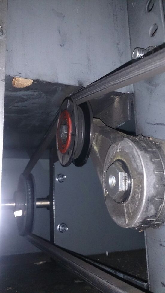

    Quote Originally Posted by Mr. Chain Blue Lightning View Post
    Jay, not sure I quite follow.
    Auto tensioners sometimes is a roller system that rides and pushes down on the back side of the belt which could bend the belt backwards causing premature wear on the belt.
    If it is something that gets regular maintenance I pull the auto tensioners off or something like this happens

    Quote Originally Posted by buttwheat View Post
    Ahhhhhhhhhhhhhhhhhhhhh! Thanks, buttwheat!
