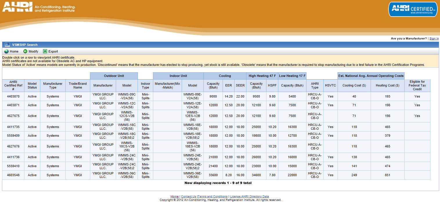

    See YMGI AHRI data sheet
    See Mitshubshi Mr Slim AHRI data sheet
    Above links are screenshots from 3'rd party AHRI performance testing for 2 flagship ductless brands: YMGI and Mitsubishi. In the YMGI cut sheet, you can see the 9000 BTU model (WMMS-09-V2A) has a SEER of 22 and EER of 14.2. On the 12k capacity, the EER dips to 12.5 while SEER decreases to 20. On the 18k/24k sizes EER falls to 12.0 while SEER dips to 18.0 and finally goes all the way to 8.2 EER / 16 SEER on the 36k. This trend is repeated in the Mitsubishi Mr Slim cut sheet where we have 26 SEER / 15.5 EER on the 9k system and then 8.0 EER / 14.5 SEER on the 36k. It does seem the EER and SEER parallel each other to some respect.
