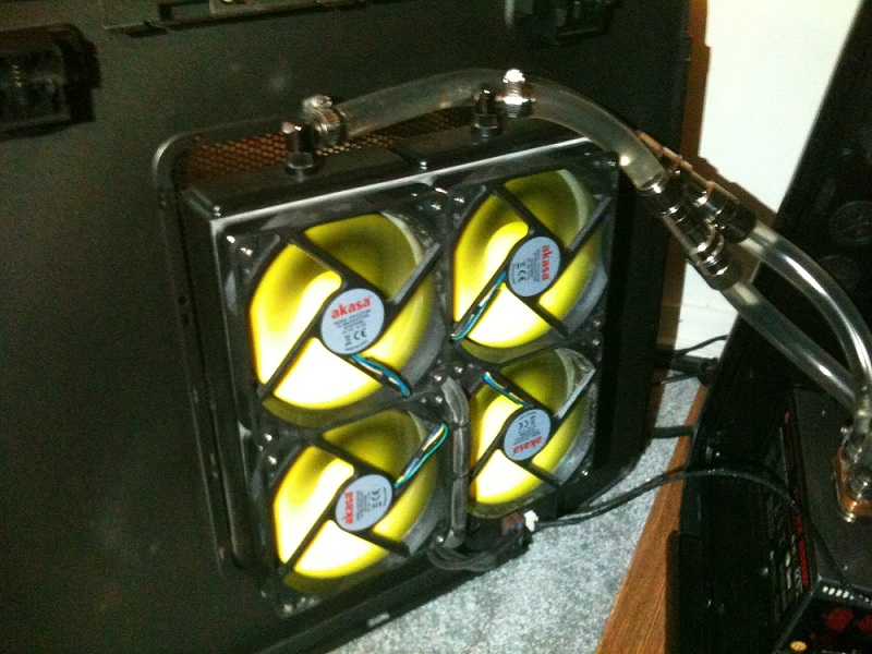

    There are a number of individuals and small outfits that make "phase change" units for computer cooling.
    The installation and operation of them is not for the casual user.
    They are typically intended for extreme overclockers that are pushing their hardware past the normal limits.
    More conventional water cooling is a better option for gamers, and other computer users who want better cooling, and are willing to put up with a little more maintenance.
    I've got 2 water cooled computer systems.
    One of the systems has a GTX580 video card that is massively overclocked and over volted to maximize its performance for a distributed computing competition.
    It is cooled by a small chiller I built to supply it with 5-10ºC water.
    This is my main system.
    The CPU and video cards are moderately highly overclocked, and run at 100% load 24/7 working on a distributed computing project for cancer and alzheimer's research.
