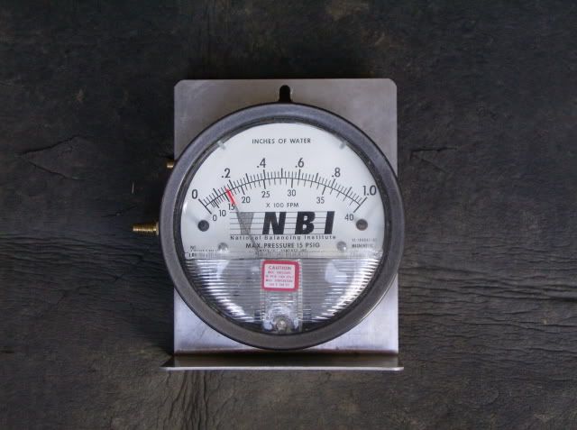

    Dwyer Magnehelic
    My choice is the Dwyer Magnehelic. High quality with permenant and portable accessory kits. I use a 0 to 2inch WC model with the portable kit for service, and setup. Comes with portable mount, fittings, hose, and hard case.

    Magnehelic 0-1" scale has very good resolution.

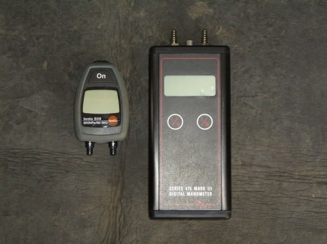

    Digital Manometers, make sure to keep them in a very secure case of some type with padding.

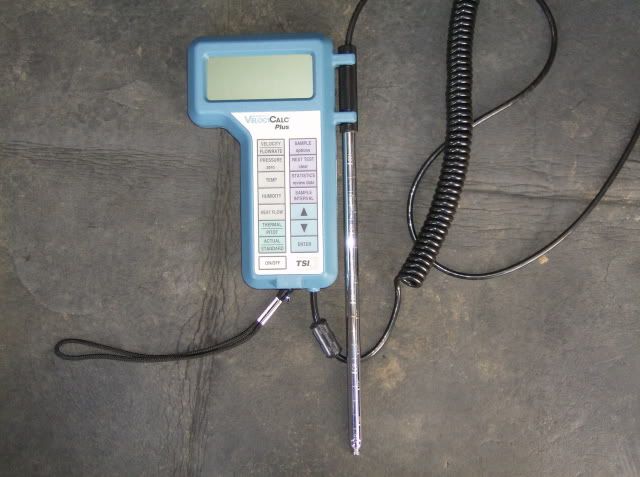

    This one I like a lot because it will do static pressure, air velocity, dry bulb, wet bulb, dew point, RH% , & CFM to name a few as well as data log the information.
    It is a Velocicalc plus
