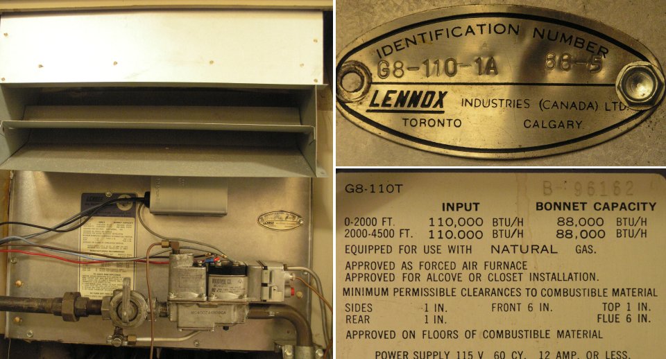

    If new evaporators are required, can they be fitted in place of the existing
    evaporators while retaining the present furnaces and ductwork depicted below?
    What chance is there that after the job is underway and it is too late to
    restore the initial configuration that word will come from the contractor that
    more work than originally anticipated is required?

    Quote Originally Posted by t527ed View Post
    its time for that whole mess to head to the scrap yard, that equipment has far exceeded it's useful life.
    Mess ? Why "mess" ?
    I looked back a bit in your previous posts for recent photo examples of current
    best practices without success. However, judging by what appears in threads
    posted by other owners, current practice comes up short compared to what
    appears in the photos above.
    And what determines useful life? Those furnaces are just some sheet metal
    boxes with motors, blowers, valves, burners and heat exchangers inside.
    It is not uncommon here for ambiant temperatures to drop below -40F
    and then remain there for ten to fourteen days each January - the equipment
    shown works on demand and keeps the building and occupants comfortable
    when that happens. It does so at a fuel and electrical cost that is tolerable.
    As I anticipate will be confirmed about the A/C units, changing out the
    furnaces in favour of current equipment will not be a trivial matter. Far
    from just an R&R of suitably sized furnaces, with THIS home, there will
    need to be a wholesale redesign of the fresh and combustion air
    supply/venting with attendent demolition and renovation involving numerous
    trades to accomplish same, along with headaches about how to deal with
    cosmetic issues regarding location of the chimneys and so on.
    In due course, that day will come. However, it seems a bit premature to
    set off on that expensive course of action when all I appear to need is a
    compressor replacement for the m/f unit.

    Quote Originally Posted by 2old2rock View Post
    I can see the cracks in those heat exchangers from way over here.
    Oh really ?
    You might want to book an appointment with your optometrist. Here, take
    a closer look ...
    I know that these images don't include the critical areas where cracks form
    in exchangers, but I am not inclined to go to the trouble of getting up in there
    just to rebutt your presumption. As one of the forum's Pros, you will recognize
    what you are looking at here.
