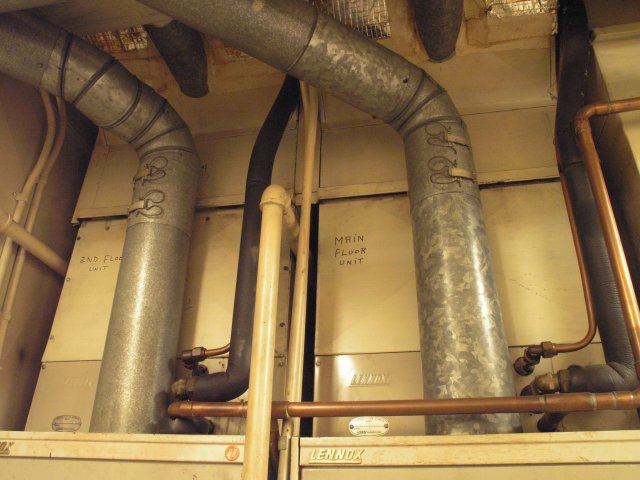

    I have a pair of Lennox G513 HVAC units cooling the main and second floors
    of a residence. The compressor/condenser cabinets are mounted on a concrete
    pad positioned away from the main building. The evaporators are integrated
    within the 60's era custom, heavy gauge, commercial quality ductwork for the
    three furnaces in the residence.
    The main floor's compressor is in need of repair/replacement.
    I have been told that these units are obsolete, their refrigerant has been
    banned and parts are NLA - the recommendation is to replace them with
    modern units.
    Are these units in fact no longer serviceable?

    I'm certain that it CAN be repaired, but SHOULD it be is the better question.
    It has had a good life, put that dog down and put a newer, higher efficiency unit in.
    Let's explore this prospect of changing out the existing units for newer, higher
    efficiency units.
    Is doing so merely a matter of replacing the compressor/condensor cabinets
    on the pads outside the home and connecting them to the existing refrigeration
    lines and evaporator units mounted inside on the furnaces?) Or do newer units
    require different lines and evaporators?
    If new lines are required, is there some means of trenchless replacement that
    will pass the new lines under a paved area that extends some distance out
    from the house foundation? Is there a way to snake the lines through the
    rear foundation wall and forward through the walls/ceiling of a developed
    basement into the mechanical room at the front of the home?

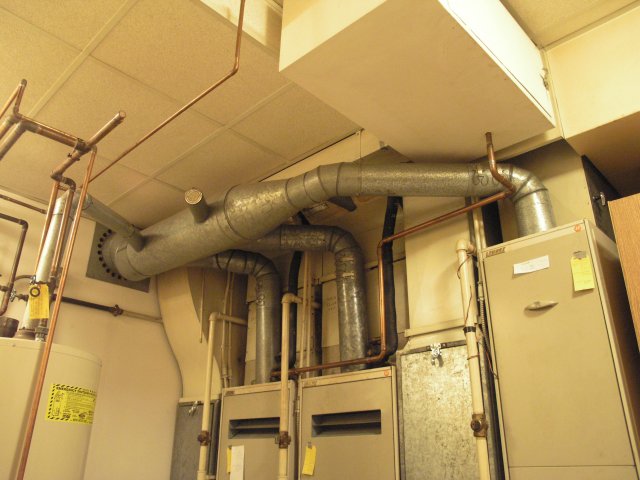

    If new evaporators are required, can they be fitted in place of the existing
    evaporators while retaining the present furnaces and ductwork depicted below?
    What chance is there that after the job is underway and it is too late to
    restore the initial configuration that word will come from the contractor that
    more work than originally anticipated is required?

    Quote Originally Posted by t527ed View Post
    its time for that whole mess to head to the scrap yard, that equipment has far exceeded it's useful life.
    Mess ? Why "mess" ?
    I looked back a bit in your previous posts for recent photo examples of current
    best practices without success. However, judging by what appears in threads
    posted by other owners, current practice comes up short compared to what
    appears in the photos above.
    And what determines useful life? Those furnaces are just some sheet metal
    boxes with motors, blowers, valves, burners and heat exchangers inside.
    It is not uncommon here for ambiant temperatures to drop below -40ºF
    and then remain there for ten to fourteen days each January - the equipment
    shown works on demand and keeps the building and occupants comfortable
    when that happens. It does so at a fuel and electrical cost that is tolerable.
    As I anticipate will be confirmed about the A/C units, changing out the
    furnaces in favour of current equipment will not be a trivial matter. Far
    from just an R&R of suitably sized furnaces, with THIS home, there will
    need to be a wholesale redesign of the fresh and combustion air
    supply/venting with attendent demolition and renovation involving numerous
    trades to accomplish same, along with headaches about how to deal with
    cosmetic issues regarding location of the chimneys and so on.
    In due course, that day will come. However, it seems a bit premature to
    set off on that expensive course of action when all I appear to need is a
    compressor replacement for the m/f unit.

    maybe "mess" was a bad choice of word......... the system is 50 years old and parts availabilty for those furnaces is almost non existant from Lennox. in the long run you would be much better off changing out the system rather than putting money into repairs.
    74,903
    Your current lines sets can be reused. A new in door coil could be retrofitted on your old furnaces.
    Virginia
    7,067
    If your service company wanted to they could find a compressor either a oe or a retrofit r 22 refrigerant is plentiful , although you would better in the long run to replace the complete system .the situation you will find at sale time is buyers will want newer equipment i have replaced units that because the new buyers home inspector recommended it due to age and the sellers never got to use the new units
