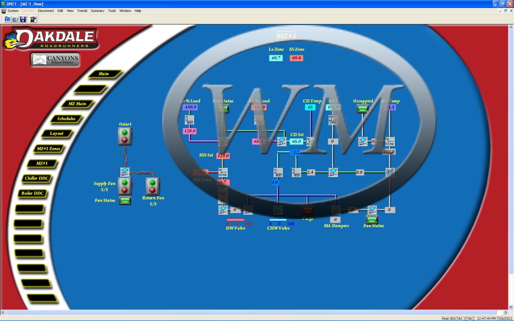

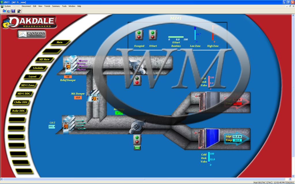

    Hey all,
    Just wanted to get some feedback on how my custom graphics are comming along for my INet 7 system for our school district. I am the HVAC Lead + Control guy for my district. We oversee 50+ facilities, 80% of which are INet.
    I have only been using INet for 3 years now and getting a good handle on the programming side, still a little confused with some calculations but with time and writing it down I catch on.
    Alot of our facilities were not programmed properly for efficiency so I am going through and starting a re-commissioning project, which includes total program tweaking and graphic upgrade.
    I do most of these graphics during my own time since at work I am really busy doing other things and making sure my techs are taken care of.
    I have been using photoshop on and off as a hobby, most for digital painting and now graphic designing for these control systems.
    I know how to create .gif files, but I do not understand how to implement them into the INet graphic page. I tried looking for the .gifs I made in the past, but could never get them to show up or any point except them.

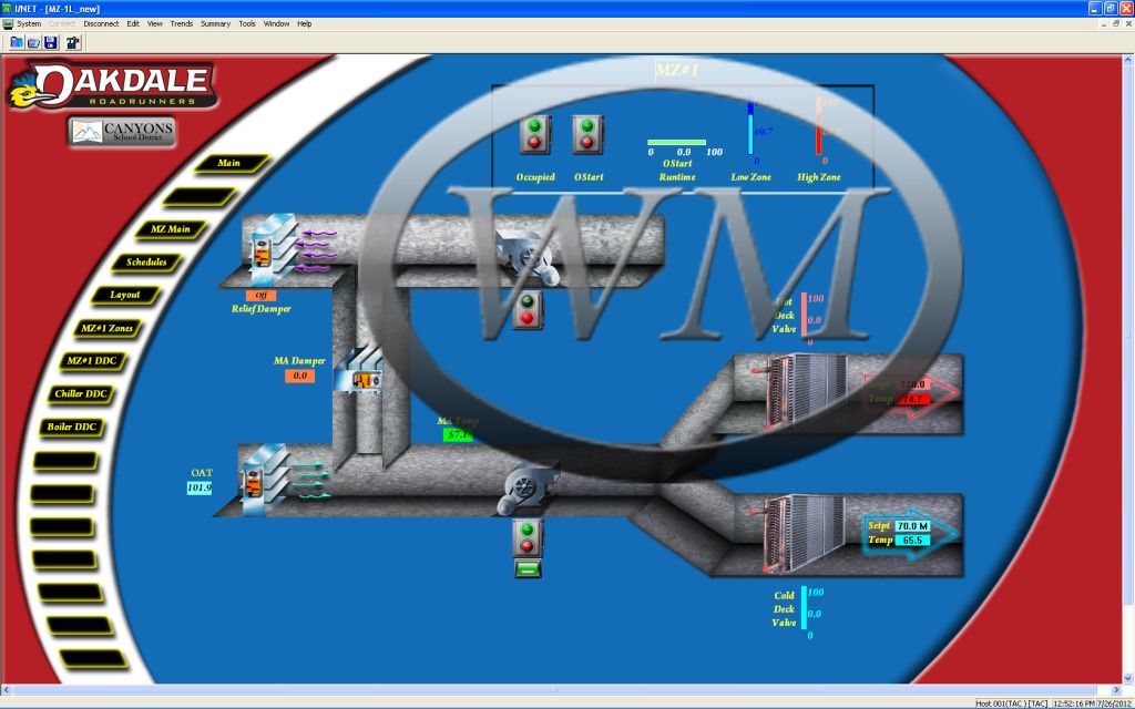

    The disconnect boxes the arm switches up/down depending if the green/red light are lit.
    I created another DI point to create a calculation for the Cold Deck coil to glow only if the Fan Status was good+CD Valve.
    Creating the Dampers was alot of fun, took about 60 layers to create, I could make them into a .gif to actuate open/close if I needed to, and would like to actually.
    Everything here was created from scratch using PS CS3 + PS CS5.
    Here is what I have so far, this is the first of 8 Multi-Zone systems on this building.
    Thank you!

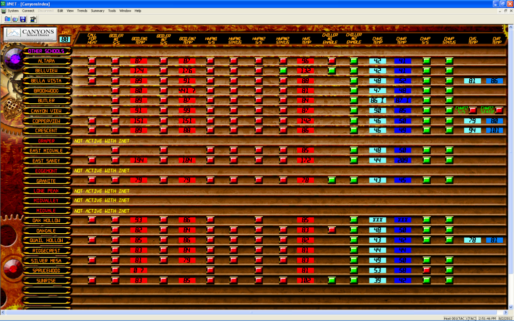

    They do look better in real time, for some reason I can't get these SS to be more HD, I will work on that later.
    I plan on making some changes to some of the graphics, I am never satisfied.
    Here is my dashboard for my elementary schools, the middle and high schools are on another one, they aren't completed.
    This gives me up to date status for each school connected to INet7, well the basics for the boilers/chillers and pumps.

    Interesting Look to the MZ #1
    I noticed the Return fans is angled in the opposite direction from the dampers.
    How did you create the Coils?

    These are all .bmp 24bit graphics. I wish I could use .png and .gifs, would make it a heck of alot easier for me.
    The return fan is just a flipped horizontal of the supply fan. I spent about 6 hrs making that fan, didn't want to spend that time again for another fan atm. I will make adjustments as I go along.

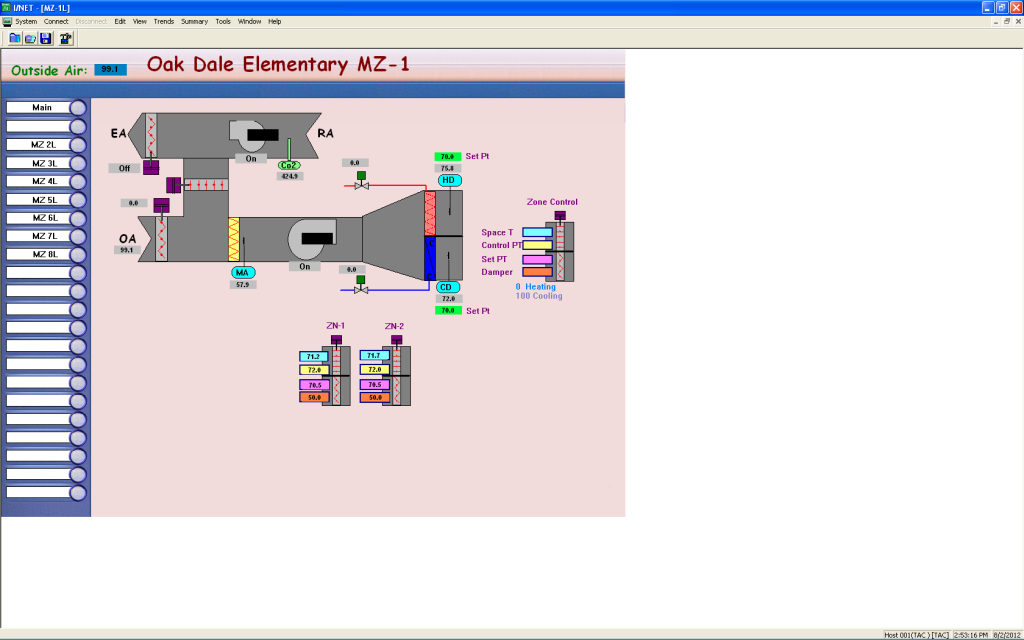

    The Problem I am having is INet does not recognize .gif, .png, etc...I have no issues converting most file types for graphics, I use currently Photoshop CS5, soon CS6.
    Here is the original MZ1 graphics, these are the base graphics I inherited.

    INET 7 treats all bitmaps as background images. To create a gif library symbol you must drop the bitmap on a blank INET graphic and then highlight the bitmap. Next save it as a library symbol. This will convert the gif or other bitmap into an INET library symbol that can be used to indicate a point state. Later version of INET7 allow up to eight states.
    The INET7 graphics editor software is old technology and cannot handle animation. I have been an INET programmer for about 30 years and still haven't found a way around the restriction. There is a front end software package called MultiLiant workstation that allows animation. The author is Dan Bellows. I don't know if Dan and his crew of scary programmers has finished the INET interface yet. You might want to google the software and see what they have.
