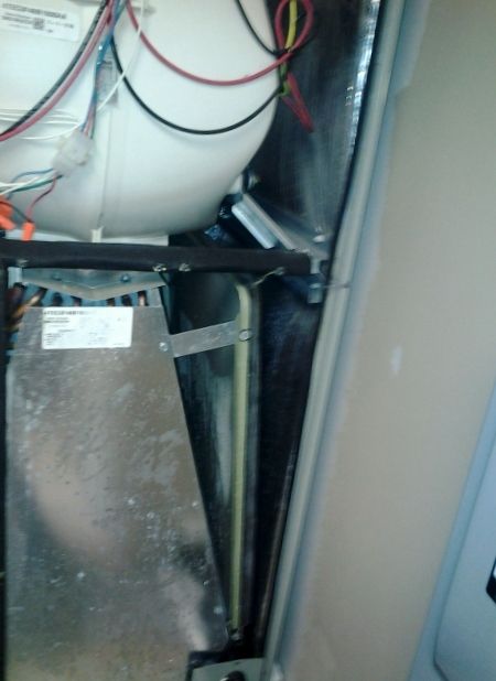

    So ok 20 years of Commercial and I really don't get around to monkeying with any thing under 90,000 BTU.
    Was working on a Carrier GTN and the Hotel manager asked if I could take a look at this 4 ton split that was dropping water all over the place
    Up flow.
    Anyway it was a block of ice when I pulled the panels so I buttoned it up and let the fan run to thaw it out. After I got done with the Chiller I went back inside, Ice was gone and then noticed this horizontal pan.
    Is this thing supposed to be removed for vertical applications ? Sure looks like a restriction to me.
    Anyway right after it thawed out I took pic and was starting to do a little investigation when a coupe of guys in shorts and torn white T-Shirts walked in and told me in broken English that it was their service call.
    They were called out 2 days ago. "See Senor" I said knock yourself out, I have a felling I'll be back soon enough probably to pull out 15 pounds of over charged R410 A.
    So here's the pic. Just curious,
    Also I'm not saying the pan is the problem but it just looks out of place. I didn't get a chance to find out why it was icing up.
    Cal
    1,625
    If it was flopped on its side and the pan had an actual purpose, would the restriction be less significant or concerning?

    mostly all air handlers are now coming multi position, in which you dont have to remove or change the pan to the other direction like in the old days.
    I will go with an airflow issue on it.
    The small Trane splits leak on the condensing units.
    FL
    571
    Upflow it comes out for efficiency. Doesn't HAVE to be removed.

    For multi position air handler. I don't think I've ever seen anyone remove but wouldn't hurt.
