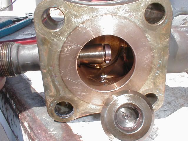

    Couple of years ago one of my guys calls me and says he thinks he has a bad muffler on a Carrier chiller, compressor trips on high head after a few seconds, here is what I found.

    Quote Originally Posted by chillrdude View Post
    Nice...ever find the clip?
    Too bad it happened on the high side. Had to reclaim it didn't you.
    Ive had that happen but on the suction side 3 times but I see ALOT of 06 comps.
