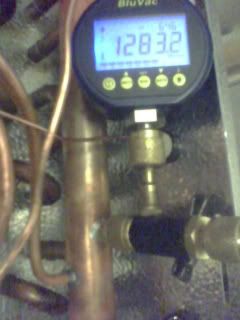

    i own a blu vac and like it alot....but the only down side that i have found is the 1/4male fitting instead of putting a female fitting on the gauge...what do u guys use on your micron gauge? a hose or another fitting?
    short 1/4" copper tube with two flare nuts/flared ends, tightened with a pair of wrenches, one end goes to a yellow jacket ball valve shutoff. I have a Supco VG64, pressure does rise no matter what I do, but if I get a good gauge I'll probably use the same setup

    I have the worst luck with micron gauges!!!! Perhaps I am not buying the right one, does anyone have a link or a pic of the bluevac? I started off 12 yrs ago with a large suitcase style supco which got stolen, then I went through two cps 100's, and I just purchased the supco vg 64 and after 3 weeks does not seem to be working right. I like the setup in the previous pic!!! Thank you
