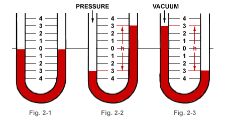

    worth reading...
    Measurement of Pressure with the Manometer
    Pressure is defined as a force per unit area - and the most accurate way to measure low air pressure is to balance a column of liquid of known weight against it and measure the height of the liquid column so balanced. The units of measure commonly used are inches of mercury (in. Hg), using mercury as the fluid and inches of water (in. w.c.), using water or oil as the fluid.
    Fig. 2-1. In its simplest form the manometer is a U-tube about half filled with liquid. With both ends of the tube open, the liquid is at the same height in each leg.
    http://www.dwyer-inst.com/Products/M...troduction.cfm
