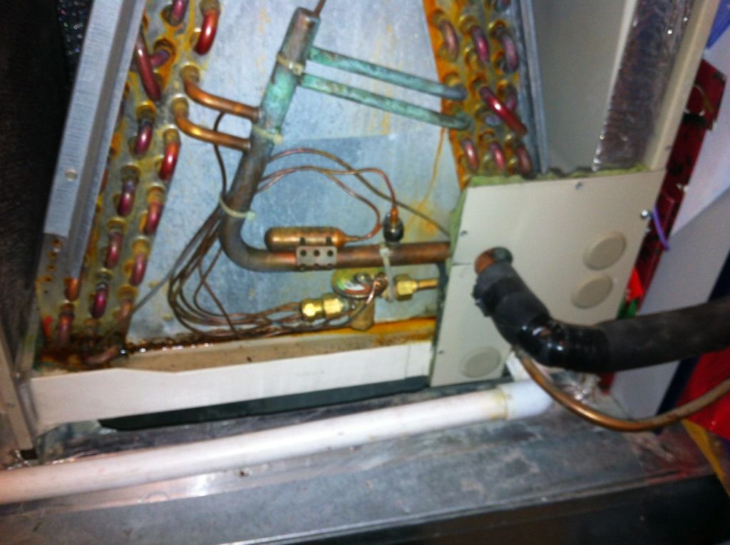

    I am looking for advice on why my Lennox Elite series heat pump is not draining properly and causing my filter to get wet while cooling my house.
    I checked for a clogged condensate drain line by running a snake through and it seems as though it is NOT clogged. The water is sitting in the bottom tray like it is stuck there. It doesnt seem to be overflowing the trays edge though. It is more like sweat is getting on to the side of the tray and causing the insulation on the front panel to get the filter wet.
    The AC seems to be working great and keeping the house cool..
    What can be causing this?
    Thank you in advance!

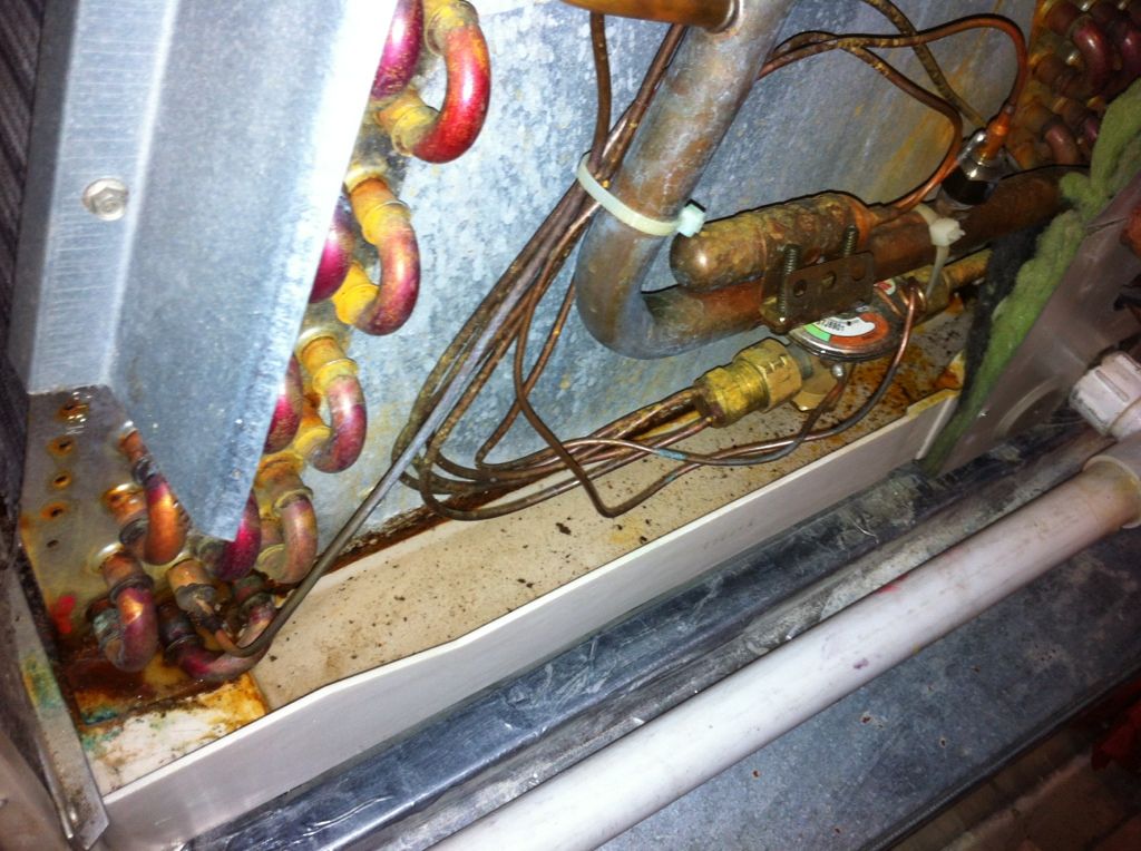

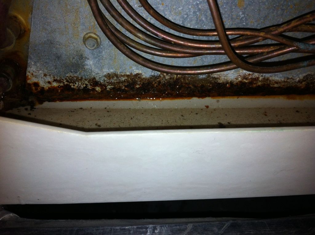

    I have the filter out and system off since it cooled down today and I was worried about damage to the unit. It is hard to see in the pic but there's 1/4" of water in the tray. And the side of the tray was wet when I opened it up yesterday after the system was running. But no more water in the tray at that time. I first thought it was from te filter being dirty so I dried out the tray and replaced the filter and let it run to find it had water in it again and the new filter was slightly wet on the edge where the insulation of the panel is close to it. I do have 3 vents closed(don't know if that would cause any concern)

    The drain needs to have a ptrap installed. The negative pressure on the drain will cause the air handler to hold water in and when it shuts off the water will rush down the drain. Sometimes overflowing the drain and thus getting the filter wet.

    The extra water in the pan won't go away. The pan is designed to hold some water even after the unit shuts off.
    First things first, open all the vents. Just cause you close some don't mean you gonna get more air somewhere else.
    Second, your stopped up filter probably caused the new filter to get wet.
    Change your filter monthly, open your vents and this problem should correct itself. If not call a pro to come check it out.

    I can not see the pictures at work, but if this is a downflow, it needs a downflow kit which is this s shaped metal that snaps into the drain pan.

    The pan needs a strong pitch toward the drain line. If the evap has positive pressure, the trap has nothing to do with draining.
