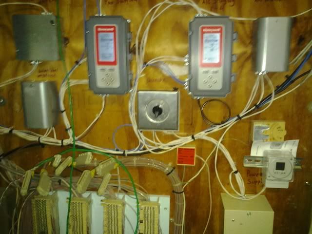

    Here's my solution to a building filled with broken unavailable Staefa junk and being limited to a budget.
    Apr 2012
    Paper Street Soap Company
    2,307
    dammit....one more time.
    Did I mention I had a restrictive budget ? Anyway after 50% of the staefa hot and cold deck controllers went south and our shop staefa stash used up and a building owner not willing to put up the scratch to install a new EMS system I resorted to T775 controllers and Belimo actuators with modulating thermostats.
    Works great. S/S on a 40 ton air handler with staging outputs based off cold deck temperatures with reset on return air. Hot deck controls boiler valve with OAT input starting boiler pump through time clock and interlocks.
    Staging controller is interlocked through AHU starter via ct....lets see T775 time clock function on the left went south after three years ( its a horrible TC anyway ) owner didnt want to buy a new one so bottom left timer is now controlling start stop.
