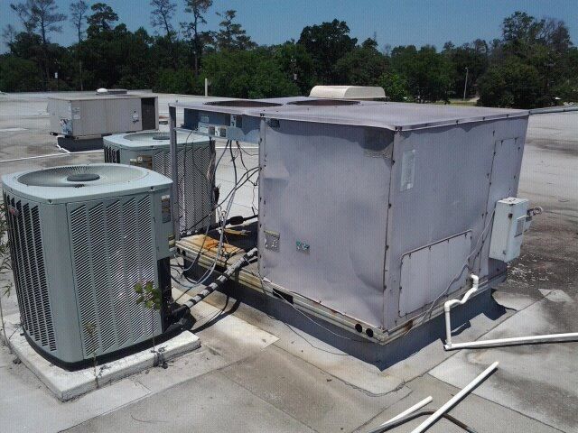

    Coil Replacement on Carrier 10 Ton
    Thats not the worst of it. We quoted the job to replace the coil that was stolen and the building owner gave the job to a family member.
    Guess he didn't have an account at Carrier.

    Is that 2 5 Ton splits hooked up to that Evap coil in the RTU?

    LOL! It's a friggin 2-stage!!!

    Or this way was cheaper lol. Carrier is disgustingly high priced for OEM stuff ... How's the system work? Lol

    Holy cats, does that actually work?

    A conversion of a package unit into a split system. Hideously clever. It's not all bad, the service ports are easier to access and the controls are simplified. You don't need to replace the panel to check pressures. Won't be burning your forearms on the hot discharge lines when you are putting the gauges on.

    It does work to some degree. A coil would have been a lot cheaper but thats assuming the AC contractor didnt steal the condensing units. The high voltage is wired to the line side of the compressor contacts. Low voltage is wired in at the low voltage terminals Y1 and Y2. They're jumped so the entire cluster......... starts up all at once.

    Quote Originally Posted by allan38 View Post
    I hope your joking. Whether it works or not its shotty workmanship to the tenth power and
    is a good example of how NOT to repair a Carrier package unit

    I agree butchers......
    15,630
    If it had been done more neatly, I wouldn't have a problem with it.
