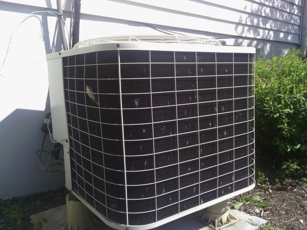

    Hail Damaged Heat Pump Outdoor Compressor
    Hello;
    In our hail storm last year, my outdoor compressor's fins were bent, badly.
    The pictures of the unit and model information are attached.
    The insurance company has cut a check to repair the fins on the unit, but with the age of the unit and the amount of damage, does it appear repairable or would it be cheaper to replace? I have straightened the fins on car radiator's before and have seen many novices get over-zealous with the straightening tool and puncture the fins. I think since the refrigerant is under higher pressure that would be more likely to happen in with the amount of straightening that needs to be done.
    The compressor unit is a Bryant 661CJ036-A.
    The electric Heat Pump it's connected to is a Bryant FB4ANF036. The insurance company only set aside one hour's worth of labor to straighten the fins, but I know to do it right will take several. After all is completed with the other repairs, I may be able to get an additional $3000 back from the insurance company.
    Would I be over-reaching to replace the outdoor unit? And, does the Heatpump, itself need replaced at the same time? Will $3000-$3500 get me a setup that would suffice for the heating load of a 2500 sqft home?
    Thanks for your assistance!

    You have what appears to be very little damage so I'd just run it. If you wish to try and straighten, then go ahead, but overall it does not look too damaged. Since you have numerous areas that are not damaged, it would probably only take an hour or so to straighten. Me? I'd not worry about it.

    ive seen new units damaged worse than yours if it were mine id just run it.
    you may damage it more trying to straighten them up.

    A fin comb and a hour will fix that.

    X4 its 14 years old "roll it till the wheels fall off" so to speak.

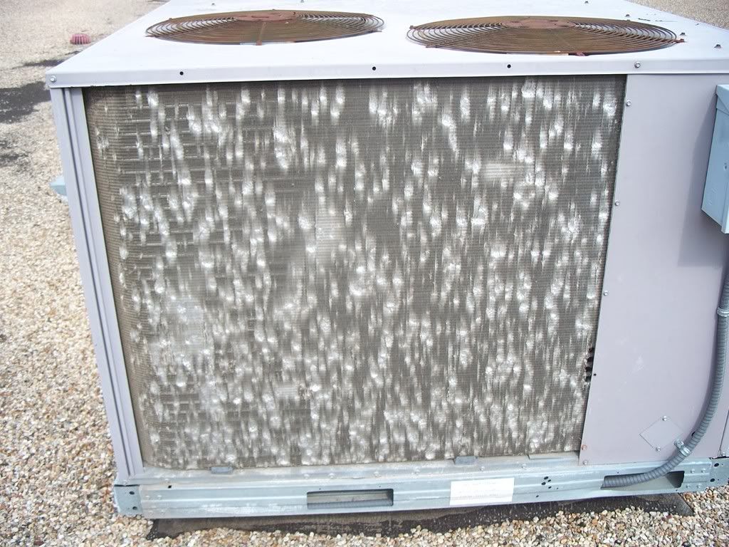

    Hail damage?
    Your condenser looks okay to me.

    John, good picture......now THAT is hail damage and VERY hard to comb out!!

    The picture doesn't do the bent fins justice. Granted, it doesn't look as damaged as the other unit pictured, it is pretty dinged up . . . the fins are bent an inch out from each ding.
