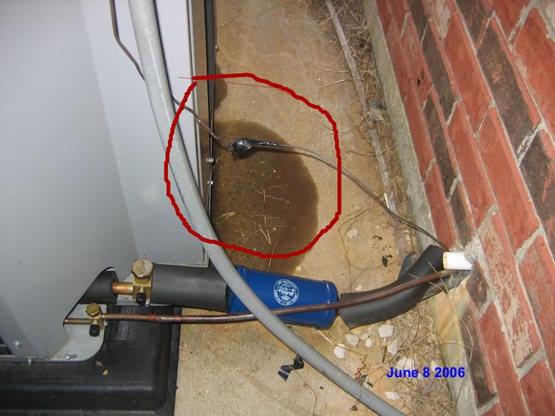

    Now this, I profer to this esteemed group, me thinks the fat lady has finally sang: (is that an oil slick or my compressor has been assimilated by the borg?). A lawyer emailed me and suggested I have a pretty good case for redhibition (that sounds absolutely lawyerly).

    Update 3. I called SEARS about getting my money back, and all of a sudden the person from SEARS legal snarled at me, saying "You got a lemon compressor, Mr. jj2000, we will replace it." Yup, they are making it really hard for me to get my money back. The really sad part is that I was the one who pointed it out those oil stains to the third contractor. Of course they can't replace the compressor tomorrow. So it will be sometime "next week." And so it comes to pass, this is the part where the lawyer comes in. All I'm asking for is to get my money back and for them to get the equipment out of my property. I'm not even going to get started about pain and mental anguish part. Heck, if y'all don't hear from me in the next week, that means I've been served divorce papers for being an incompetent man of the house.

    @acoolguy- The blower motor quit after the 2nd contractor came in and diagnosed the problem to be a damper impeding air flow. The following day, the line froze again, this time accompanied by a grinding sound see video: http://www.youtube.com/watch?v=jiAHylUNnDw
    Contractor 2 comes back, diagnoses the freezing problem as due to a failing blower motor. Puts in the blower, leaves, but had to return because I called him and reported that the blower was blowing hot air while the compressor was cutting off and on every 1 to 2 minutes. It was painful to hear. And then it quit running. Completely. Now SEARS thinks I have a lemon of a compressor unit.
