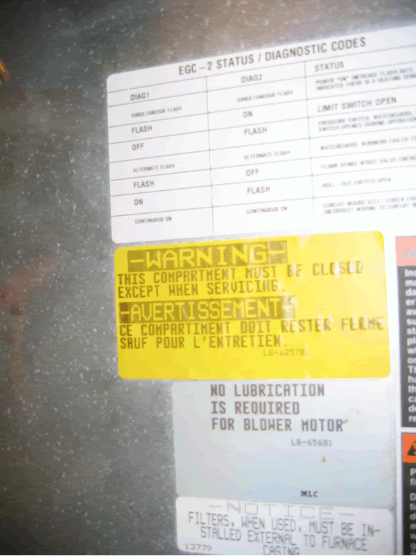

    Opened the service panel and took a pic of what I saw. There's a sticker that says EGC-2 status code:
    A closer pic of the condenser:

    Take a pic of that sticker in your last picture of the "condenser", which is your air handler inthe attic. The model and serial number should be on a sticker on the outside of the unit, unless lennox is different than most.

    Model number should begin with G or 78, 88 or 90. About 8 digits, letters and numbers.
    Also, there is only foil tape on that plenum transition. It will not hold. All seams should be made up with a mesh or cast tape and sealed with duct mastic which looks like real thick paint.
