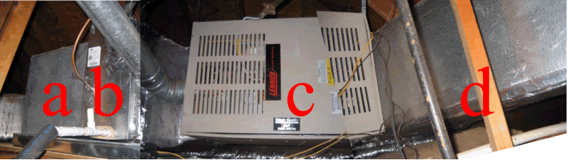

    You have airflow problems. Is the blower wheel clean where it scoops the air? What size blower do you have. If it's a four ton unit you need a 1600 cfm blower. Somewhere in that system you have airflow issues. Is the duct adequate for a four ton unit 1600 cfm? If the airflow isn't right then you won't create enough load on evaporator to keep it from freezing. Oversizing can also be an issue..Get someone who knows what their doing out there...
    12,994
    I have seen liquid line driers used on suction lines, I wouldn't ,can't really see what the dia. of that drier is .Why would this hack have a 7/8 liq.line drier on his truck. That's heavy commerical.What's the model # of the furnace.This contractor KNOWS the R A has some issues if he told the H O to remove the original filters.

    suction line
    assuming your model no. capacity is 44, it appears you dont have a 4 ton (48,000 btuh) but a 44,000 btuh unit. also it appears your liquid line drier is installed on the suction line. if your txv is located at your ahu then you have a restriction in your drier that is acting like another txv (thermostatic expansion valve)-note the freezing of the drier when the unit is on. replace the drier, and get a price reduction on the installation of the unit for all your wear and tear on your nerves.
    12,994
    Yes , first thing to do would be to get that drier out of there and put the right part in its place. Then start trouble shooting this unit. Do we all agree that this drier shouldn't be installed on the suction line . Sometimes the answer is right in front of you . Now , why didn't I think of that?

    Hi,
    Thank y'all for your responses. The contractor came in, replaced the tstat, went up the attic, and found an obstruction in the "squirrel cabinet." It was a large piece of insulation he says may have been from a previous install or servicing job. He was 99% sure it was the cause of the icing. The unit worked fine Sunday. My wife comes home today, calls me on my mobile, and says it is freezing up again.
    Notes about the visit: I quizzed him about the drier and he says that it was in the right place. He pointed out that the size of the tube fit the suction line diameter.
    I am going up the attic and take pictures of the blower etc. to let ya'all get a glimpse of what is going on. Edit: I have become sort of familiar with the external unit but the stuff in the attic is new territory. I know where the evaporator is (b in the picture?). Where might I find the specs for the blower or even take a picture of it? Everything looks taped up and I don't see any access panels. Thanks.
