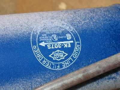

    I hope the thermostat is the problem (did a search on this forum and found at least 2 hits indicating possible relationship with freezing). I did my own investigation and suspect something is not right, i.e., liquid line drier on what I suspect is the suction line? I this a proper way of installing the drier? I have attached a couple of pictures that would pretty much sum up my predicament. I would appreciate any comments from HVAC professionals on this board:

    Gee i love your low volt wiring! did they replace the line-set?I was always not to leave a suction line drier on a system longer than 2 weeks,have them check for pressure/temp drop @ the suction line and the drier

    That's either a suction line drier or an accumulator.

    @star882 It says on the casing "ALCO Control" Liquid Line Filter Drier Model EK-307S. Apparently, there's lot of this stuff floating on EBAY. Pls see pic below.

    First off, they have a liquid line drier installed on the suction line, and no visible drier installed on the liquid line, unless it's factory installed inside the condenser. If that's a heatpump, it appears to be the wrong drier. You really need to go talk to Sears about getting a contractor of your choice out to correct your problems. If the unit is turning on/off, it's not your t-stat causing the freezing problem. Tell Sears you expected more from them for your $$$, and sending Larry,Mo and Curly to diagnose the problem isn't going to cut it. With their "customer satisfaction" warranty, they'll receive their next payment from you when you're satisfied. Good luck.
