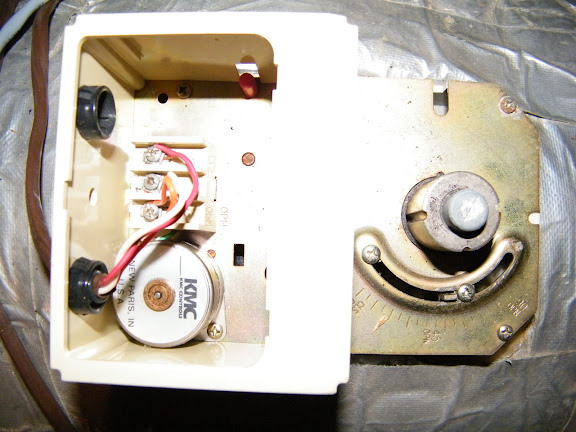

    Finally got up in the attic with a camera. Here are some pictures of the damper actuators. Does anyone know if they're repairable, or am I going to need to have them replaced?

    and a couple of pics
    Thanks!

    It's toast!
    The good news is that most brands of damper motors will work with the existing dampers, so no cutting into the duct.

    If you notice, there is a screw between 45 and 90. That is there for air balancing purposes to prevent your damper from opening to much.
    While it is good they did the air balance (and a must) the problem with an actuator like that is when it hits the screw it tries to keep going for a period of time. During this time the cogs on the gears skip and wear out over long periods of time.
    The noise you are hearing is the rub of the skipping gears that are now worn out.
    You will also notice towards the top you have a fat red button. This button is the gear release. The bar against the screw is to show the current position of the damper.
    Push the red button in and hold it. Turn the damper clockwise until that bar is no longer against the screw. Release both the damper and the button. If it still doesn't move but you can hear the rubbing gear cogs you will need to replace the actuator.
    If it does move (most likely but may not rotate all the way back to one screw or the other) you have a different problem.

    The root of the problem is that those particular actuators were not specifically designed to be powered all of the time, so they don't have any internal circuitry to keep them from continuously driving against the range stop.
    The original zone control panel they were used with would only power them open or closed for a minute or 2, then stop powering them until the next time their position needed to be changed.
    Most of the newer add on zone panels power the damper actuator one way or the other continuously.
    The newer actuators typically have circuitry built into them to prevent them from driving against the range stop constantly.
    Specifically I've had complete success with retrofitting EWC damper actuators on those dampers.
    They also give a nice red light/green light indication that they are fully to the closed or open position.

    It is the EWC "MRK" motor replacement kit. It comes with mounting hardware for a number of applications, including a bracket that will be needed to secure it to the body of the damper assembly.

    Thanks for all of the help guys... I think I'll have them replaced with the EWC MRK style if they'll drop out after they reach the open or closed position rather than just sitting there clicking and chirping away.

    Thanks for the recommendation Mark. The EWCs have been working great for a few days now!
