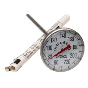

    Quote Originally Posted by cold55 View Post
    Or is there some other way for me to check?
    Here is an old fashioned "low tech" method.
    Place it in a register that is easy and safe to access. Then start monitoring your temps. When the temps aren't what they used to be something is needing attention.
