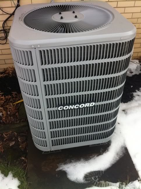

    Hey fellas, how is everyone today? I am hoping I could get some advice here and hoping I can be pointed in the right direction. I'm a novice, and really need to see what the problem is. I read through some threads today, but still can't make sense as to why my electric bills are so high.
    I am going to be as thorough as I can and include pics hoping that will help.
    Some background:
    - Live in the Ohio Valley, Northern WV panhandle area
    - 1 story brick home
    - 1200 square feet
    - hard wood flooring
    - insulation and windows are fine (according to the guy who installed my new furnace and heat pump anyway)
    - all electric home
    - I live alone - no other human beings in the house
    - One vent in each room, a couple of intakes throughout the house, but NO VENTS in the hallway or the dining room
    - I keep the temperature on 60. Yes, 60.
    Purchased my home in July of 2009. The HP and furnace were old, but the heating and cooling worked well. My first summer and winter were high, but nothing like the next 2 winters. In the summer of 2010 my central air quit working. All it blew was warm air. I went without any AC that year and just had to use a window unit and carry it from room to room with me (talk about a pain!) because I didn't have the $ to purchase a new HP.
    That winter with no HP I had just the electric furnace. The first month of winter the electric company decided to not read my meter for like 34 or 35 days. My first bill was $445. I had it on 64 that month and about soiled my pants when I got that bill. I instantly turned it down to 60 after that, and no matter how little I used electricity that winter, it was consistently $250 and up.
    Come spring 2011 I wasn't going through another summer of no central air so I dug as much as possible in trying to find a new heat pump. Had one service call and it was about the worst customer service I've ever had. They said it was $$$ for the call, but charges me $$$$ after all of the testing was done, and all he said was that the Hp was toast. It wouldn't be beneficial to replace the compressor (which was what went bad). I did a little more digging and found out that the payroll lady at the school I taught at is married to an HVAC guy (Jim) with 35 yrs experience. I called him, he came out for $$$ to look at it, then 2 more times for free. Heck, he even called me a couple of times with some other ideas on why my electric bill was so high. We found out that the heating element in my sink that gave me instant boiling water was broke and running 24/7. That reduced the bill about $40/month, but it was still high.
    A few weeks later Jim calls me back. He says he is looking for a HP for me and hoping we can save the furnace. He said I had a 3 ton HP and it was way too big for my duct work and that was the reason for the compressor breaking (something along those lines anyway). A few days later he calls me and said a salesman that's been wanting Jim to buy from him gave him a deal with prices he hasn't seen in 10 or 12 years. A new HP and furnace for half the price of what the HP I was getting quoted. Now, I knew his wife personally, and the guy came to my house several times for free and only charged me $$$ the first time he came, so I believed him that it was just a very good deal. (He was A+ with everything - a very honest guy.)
    Anyway, he replaced the HP and furnace just before a ridiculous heat wave came. I kept it cooled on 77 or so and was still getting bills that were high in my opinion. Anywhere from $100-$150 a month. Again, I live alone, and use little to no electricity. Before I bought my home I lived in an apartment and had it down to a science. Even had a $10.62 bill once, and I stayed there every night that month, and it was an actual reading. Come the fall the bills went back down because I wasn't using the AC or heat.
    Then winter came and it's been very, very mild. I just looked at this months bill and last month the avg temp was 10 degrees higher (32 degrees) than it was in 2011 (22 degrees), but yet I am still getting electric bills in the $200-$250 range. I wouldn't mind that if it were 68 degrees in my house and I had a family, but I got this sucker set at 60 degrees, and I am gone 12-18 hours a day. I just don't understand it! I'm so sick of these bills I could puke! I have done everything I can think of to reduce my electric bill: energy efficient bulbs, power strips for all vampire electronics that gets turned off at night, nothing but the fridge runs when I'm not there. I just don't get it.
    Here is my reading from last month's electric bill:
    7.4 center per kwh
    Total kwh used: 1688
    kwh per day: 58
    Avg temp: 32 degrees
    Total kwh for the previous 12 months: 15,200
    My bill was $200 with fees, and again I am keeping it at 60 or lower. I got fed up last night and tuned the heat down to 50, closed my bedroom door and used an electric space heater.
    Here are the readings for the last year:
    Feb 2012: 1688
    Jan 2012: 2251
    Dec 2011: 423
    Nov 2011: 316
    Oct 2011: 987
    Sep 2011: 1285
    Aug 2011: 76
    Jul 2011: 570
    Jun 2011: 401
    May 2011: 702
    Apr 2011: 2047
    Mar 2011: 2695
    Feb 2011: 3447
    I will post pics of my HP, Furnace, Thermostat, and space heater. If you guys can see anything that I should check or that seems funny, please let me know.
    I know that was long - thanks a lot for reading. I'll spare you of any more details and drag this out anymore.

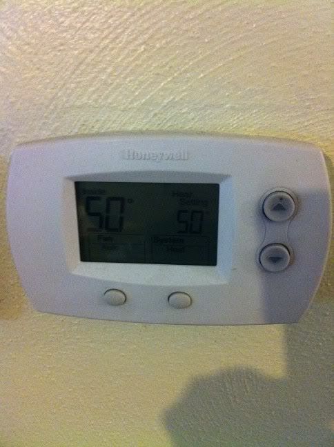

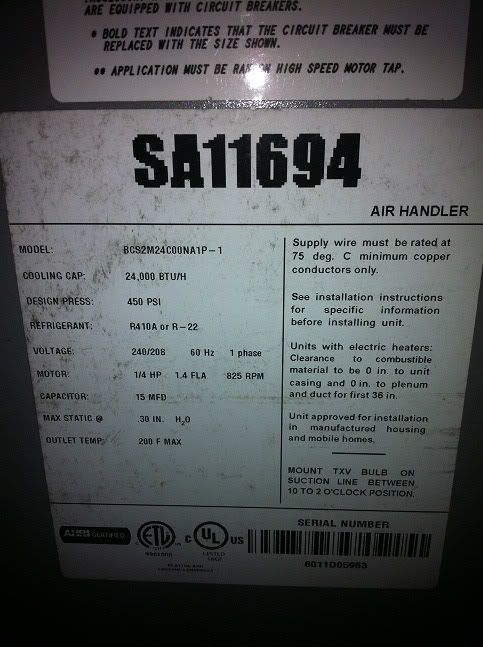

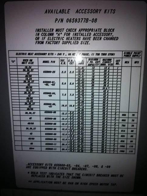

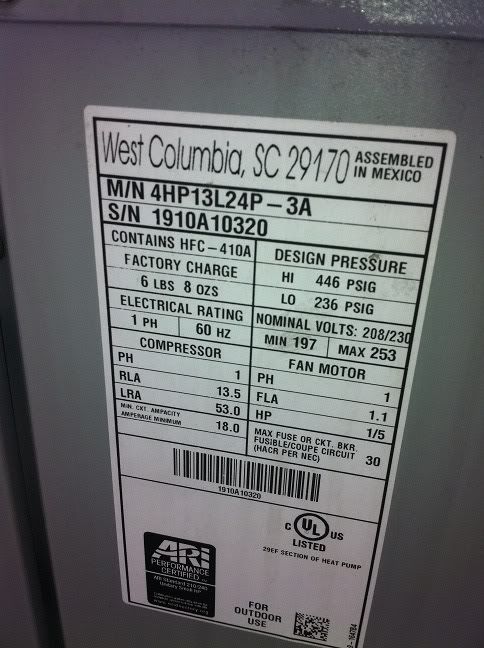

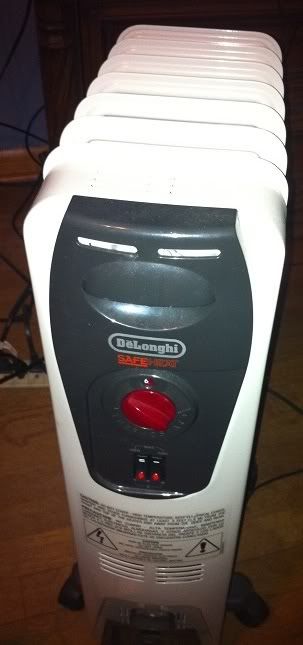

    I have no idea why these are sideways, they saved standing up.
    Furnace
    Furnace
    Heat Pump Literature
    Heat Pump
    Thermostat
    Space heater
    Is that space heater going to kill my bill is I have the furnace on 50?

    If you look at your electrical circuit breaker board, you'll find a very large breaker at the top. Shift it to the "OFF" position and your electric bills should then be in the $10 to $15 range as you anticipate. Otherwise, you're going to have to pay for the privilege of purchasing electricity.
    Now that we've got that settled (at least I do) let's do something constructive. Locate your electric meter and observe that the horizontal disk is turning. Now go into your home and turn off the HP. Use the circuit breakers to the HP and separate breakers for the electric heaters. Now go outdoors and re-inspect the meter. Is the disk still spinning? Faster or slower than before? Repeat this inspection as you turn off each additional C/B in your house until you've got them all turned off. When they're all off, the disk should not be moving. Is it?
    Now you can begin turning on 1 c/b at a time and observing relative speed at which the disk spins. The faster it spins, the more you're paying. Many of our modern conveniences eat gargantuan amounts of electricity. For example, granddad's old refrigerator used a fraction of that consumed by your frost free refrigerator. T.V.s, cable boxes, computers, everything that runs on electricity and is either "instant on" or has little light to indicate power is a consumer of electricity. Even you cell phone charger when it's not charging has the light and is consuming electricity.
    Sure, the HP is a big user whenever it's running and the electric resistance heaters are even worse. There are ways to improve on that use but you've already spent the cheap way out and now you're getting that for which you paid. A good, competent (very difficult to find) company would have done a load analysis of your house before specifying a new HP. Then there would have been options offered for different efficiency products. Of course, the cost would have been much more than I'm sure you paid but in the end, you asked for it. Energy efficiency costs.
    So your only alternative at this point is to tighten up the house. Find all the leaks and seal them. Use foam, silicon sealer, plastic sheeting and other things. If you've got an attic access panel, use that access to get you into the attic, pull back the insulation in each bay and seal any leaks you can find (holes for pipes or electrical wires, recessed lights but be careful about those that can be in contact with insulation and those that cannot, voids where house angles occur, etc.) Once you've got all the attic leaks sealed, then insulate the daylights out of the attic. (Don't forget to seal the attic access panel too! If it's a pull-down, you can purchase a styro-foam cover at the big box store). Then when all that's done, start on the crawlspace or basement if you've got one. If you've got 2nd floor bedroom/bathroom windows, consider blocking them off in winter with insulation sheets, if you're not up there all day. And if you do all these things and pay attention to what's running and what isn't, you might get that bill down $100/month. But I'd guess the days of running a home with a HP for $10/month are probably behind you.

    I checked that today as I was taking the pictures I posted. It is moving very slow. I had the heat still on 50, and the only things turned on were the fridge and the water heater.

    Whenever you try to buy a new appliance that uses electricity, there is always a yellow tag that states the estimated energy usage of the appliance in kwh. See if you can track down that info for your major appliances including the HP.
    I would also still do the circuit breaker routine mentioned above, with one difference. Don't turn off your main, turn off all the breakers one by one. After the various breakers are off (except the main), your meter should stop incrementing. If it still does, that means that something is using up some current and is not connected to a breaker, which is a very bad thing.
    You should probably call an electrician at that point. I hope this provides some sort of direction.

    The SEER rating of the system, 13 is the magic number. That rating number means essentially the number of Btu's your unit can achieve for each Watt of electricity purchased. Thus, in your case, 13 Btu/Watt x 1,000 = 13,000 Btu/kW. Some of the inverter HPs now on the market are sold as 24-SEER but independent testing is showing them to be putting out as much as 28-SEER under partial load conditions. I always expose my potential customers to all the efficiencies, bells and whistles at the time they are considering their purchase so that they can make the decision that makes the most sense for them. My opinion has little to no bearing on the issue. It's all about the customer. So when I see a 13-SEER system and read you initial post about the cost of getting a tech out, etc. it just seems to me that you asked for cheap and that's what you got. A single man who's making a few bucks on the side and he got you a system at some significantly below market price. And if that's your choice, that's fine with me but the operating costs are what they are unless you take steps to lessen them. Seal the envelope, then insulate it and when you get it so tight you need mechanical ventilation, you'll know you're at the lowest operating cost for that equipment.
