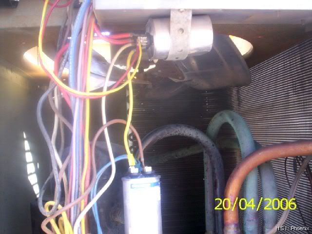

    well today pulled up to yet another maintenance and look up and see a goettl package unit. go in and do the usual ask is any problems, bla bla bla. she happend to mention that last guy was here charged this sweet little 84 yr. old widow $649. and told her "IT WILL LAST FOR YEARS NOW"!
    guess who was out here last? she doesnt remember his name but describes him as REALLY BIG!

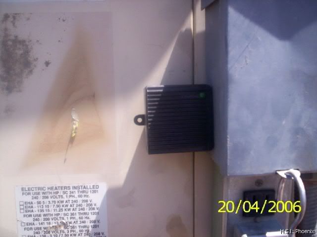

    couldnt get panal off very easy cause surge protector over panal. could have put it on other side of disconnect but no!

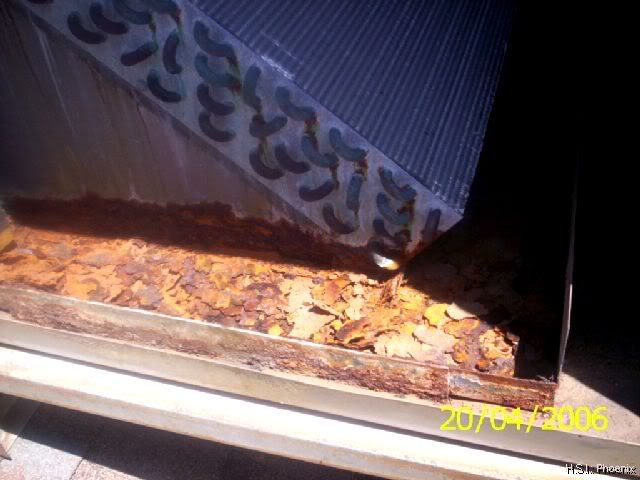

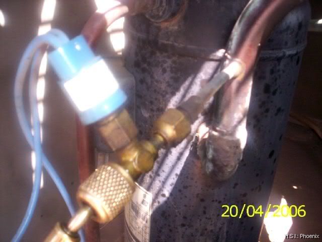

    inspection of unit the pressure switch is leaking a little!
    this is what was in the drain pan
    oh the best of all

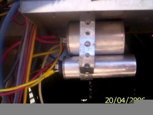

    look what i found!!!!
    thats right. cap hanging by the wires.
    SLACKER!

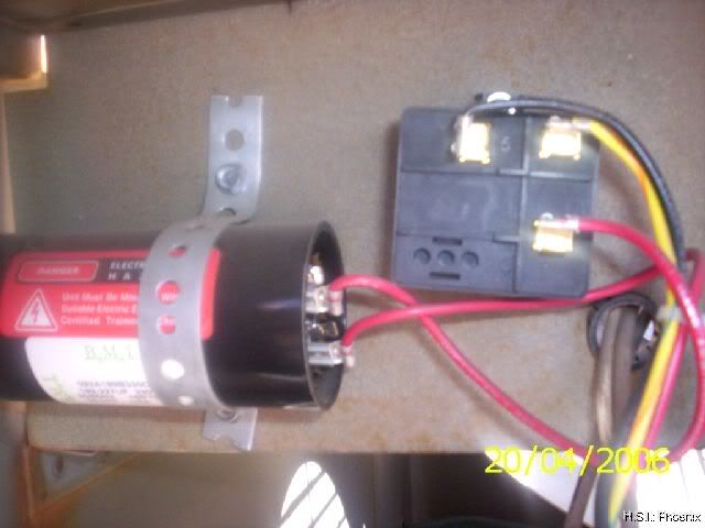

    so look what i did. took a hole 2 minutes to do and it looks good.
    i am glad to see he did strap something up!
    so talking to her again about my finding, she said how she only gets $700 a month to live on.and when he sold her all this stuff she said he was up on the roof for only 10 minutes and in his van for over an hour, and was very conserned that he did change out the parts he said!she couldnt find her copy of the invoice but i told her ther was some parts changed out.
    but i didnt tell her that things were not done correctly, as bad as i wanted to!
