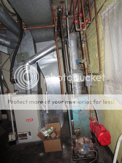

    I'm calling my landlady tomorrow. I live in a 2-flat, landlady lives downstairs. We have a natural gas fired boiler with hot water baseboard heat. Our apartment is appx 1100sq feet. My thermostat is turned to 80... yet it is 53 degrees in my house. Windows aren't leaking, insulation isn't THAT bad... honestly this is frustrating. Now, landlady has HVAC people that come to fix our stuff (there's a sticker on the boiler), Guth's in Chicago. Don't know how reputable they are.. but yeah.
    So anyways- I went down there tonight because I was curious about it- maybe the pump wasn't functioning.. I don't know. But it's OLD. The pump, the boiler...
    Ideally I'd like someone here to just let me know what you see- how old are these units? Any other observations? Can you basically tell me what all of these things are and what their purpose is? What should I see if they are fully functioning? Are they dangerous at all? Should the be replaced? Here are photos...
    Standard cylindrical hot water boiler- I don't know if this is ours or not, but I assume it's for our hot tap water and such?
    The setup. (The forced air system in the back is the landlady's.)
    The 'ol boiler herself.
    The pump, I'm guessing?
    I noticed this thing on the ceiling... what is it?

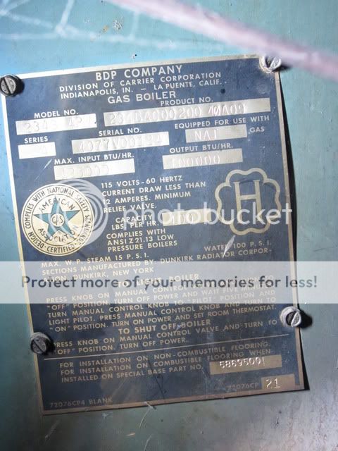

    Another shot with words on it (click the link, I could only add 11 images to the post)

    There is only one component you need to be concerned with that is the circulation pump. If your pump is running and your boiler pressure is above 10 PSI you can check for bleeders on your baseboards and see if you get any air out. If your pump is not running or your boiler pressure is below 10 PSI you need to shut the system off until a contractor can make it out.

    What part of the structure is the forced air furnace heating? 80-100 degree radiator temp obviouisly won't cut it for heating. I suspect a circulator problem which will require a professional. That system is set up for purging(bleeding) in the basement so you most likely will not find bleeders on any of the radiators. Also appears that one of the boiler sections had an issue and that the boiler has been derated. Call the landlord.

    The boiler originally had an input and output rating based on the number of burner tubes installed by the manufacturer. If one of the tubes has been removed and the orifice plugged, then the boiler will have less input and output than it had when it left the factory.
    I note that the landlord's warm air furnace is brand new,while your boiler is aged and in poor condition. I don't know if your baseboard heaters are finned copper or cast iron and the heating characteristics of each are quite different. Cast iron could produce useful heat in the low 90's on a mild outdoor temperature day but finned copper needs to see an absolute minimum of 140F to begin to produce heat. On a cold winter day, it needs about 180F or more if it's design temperature was higher. I've see installations designed for 220F temperatures!
    The problems with your heat could be multiple. You need a good tech to diagnose and cure the ills as much as possible given the equipment limitations. There is little you can do to improve the situation, except to be absolutely sure that the underside of the baseboard heaters are clean! I've found many homes with a screen of dust blocking all air circulation through the finned copper baseboard. The end result of that is insufficient heat. So...be advised of that issue. All other issues need a heating tech to be resolved.

    That B&G circulator pump does not appear to be in bad condition. Looks newer than the boiler for sure.
    I don't know how much I'd trust the gauge on that boiler.
